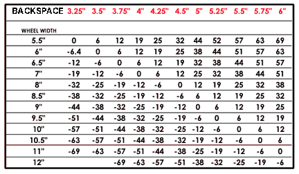

Offset to Backspacing Chart

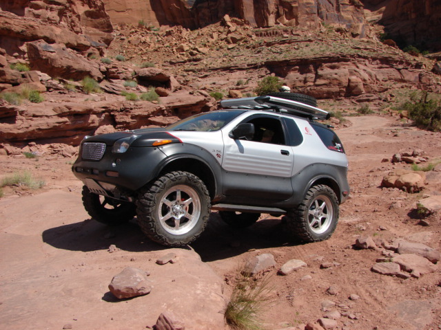

rickshaw
Rims are KMC XD Monster 18x9 (Offset +18mm) (Back Spacing 5.71in) (Center Bore 106.25mm)
Tires are Nitto Terra Grapplers 285/60/18 (Diameter 31.38 in)
(Lifted) OME 913's, 2" torsion bar crank
