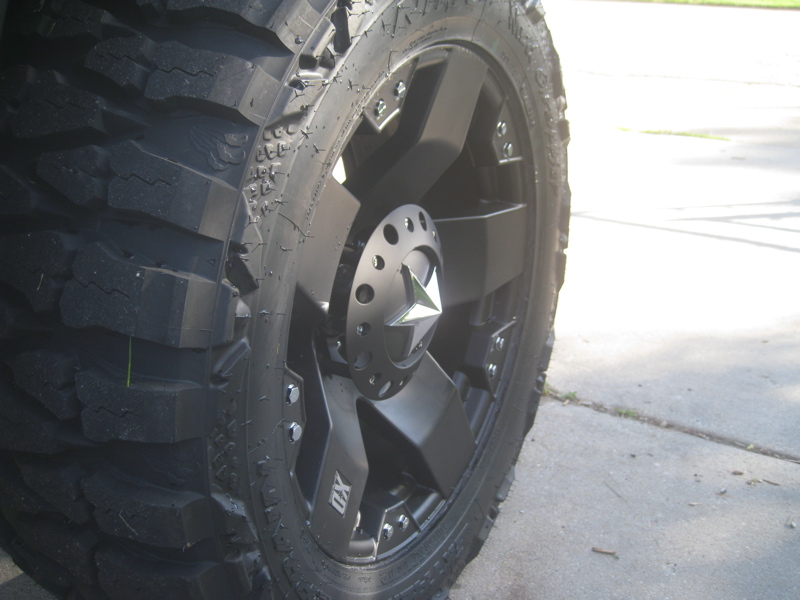

Wheels and tires ordered... 05/27/08
20X8.5 +10mm Offset 108mm Center Bore
33X12.5 Nitto Mud Grapplers
That's all you're gettingNext update will be when they're on the vehicle

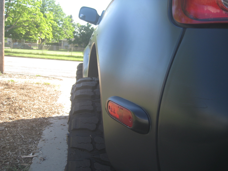

6/7/08
Finished up front (except for tierods which haven't arrived)
All bushings bumpstops were replaced, Ball Joints Flipped, Wheel wells trimmed, Sliders Trimmed, and Wheels/Tires installed
IMAGES BELOW
