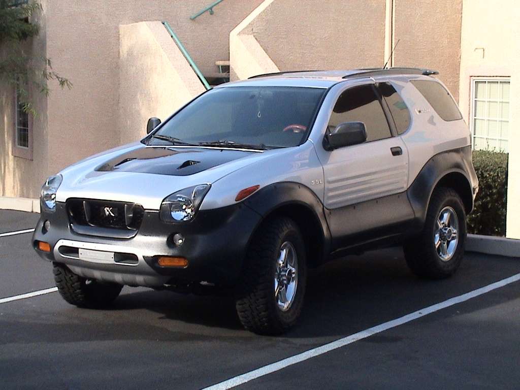

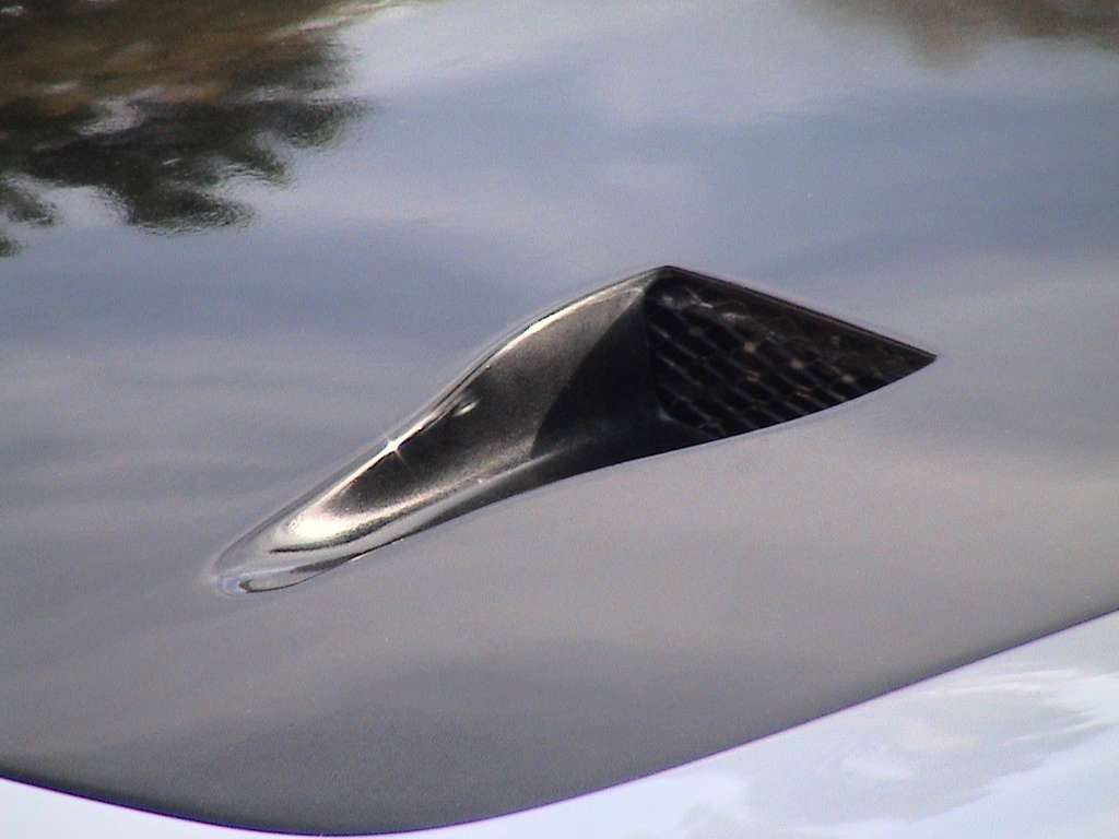

    I've been waiting a long time to get up the kahones to do this. I've always loved the way these look on High-End sports cars/rally cars/etc... So, I took 2 days off of work and just DID it! I installed NACA ducts in the hood... and yes, they are functional! (what do they do? well, um... they let air into the engine bay right now... AND LOOK COOL DOING IT!! ) Eventually I'll get them ducted toward the air cleaner, but for right now they just totally give the agressive look I've been wanting for my VX. I've attached some pics of the process and the end product. Let me know what ya'll think!

    Very Nice...I mean wayyy nice...
    I've been wanting to do the same for some time...only I was thinking of putting one directly over the airbox to dump fresh air in,& the other in a corresponding loca. on the other side of the hood, maybe even another center forward loca.
    I've liked the look of NACA ducts since the first time I saw them on a 69 GT 500.
    Good to see what they'll look like, that really kicks!

    Yes, eventually they will be plumbed into the airbox, but right now I'm out of budget $ and time.

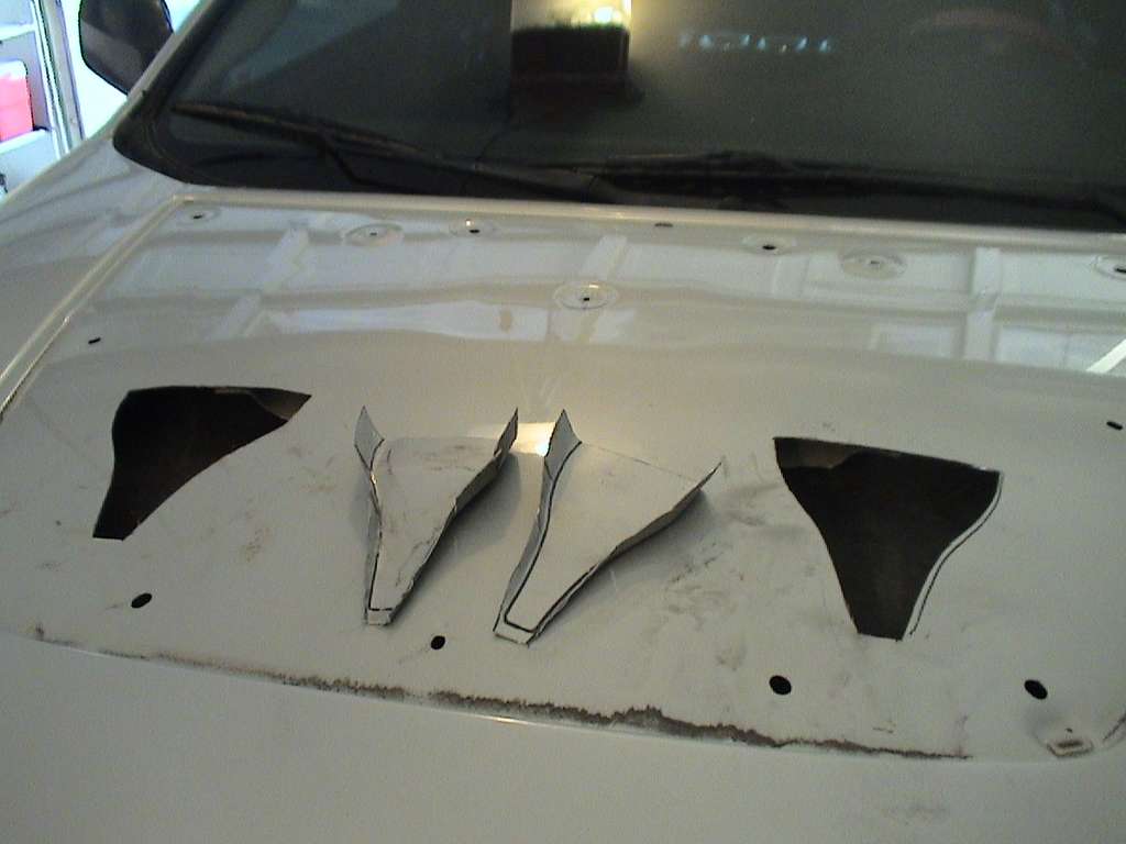

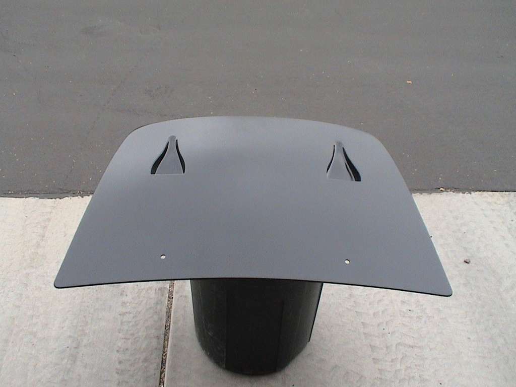

    As for the ebay question... no, these are 100% hand made. I started it by designing the shape on Adobe Illustrator. Then measured the insert for placement. Then, cut out the insert, cut the sheet metal hood below the insert, and used the cutout pieces as the "trays" for the ducts. From there, fiberglass and body filler went into play...
    16 hours later...
    They are done!
    Only one thing I'm going to fix... I added a mesh screen. I don't like it though. It's used to cover up the bare sheet metal and hood structural supports. So, I'm going to cut the hood about 5 inches more toward the interior so that none of that will be seen, and I wont need a screen.
