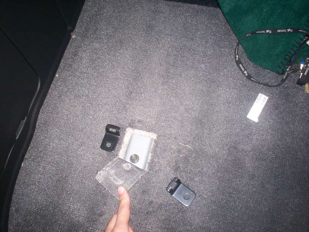

yeah i dont think bimati needs them and i certainly dont, ill take some photos of them and where they mount when i get home tonight and you can decide if u can use em or not

They are on all years including my 99. If you look VERY closely at the rear carpet (to the rear of all of the seatbelts and seat latches, but forward of the rear cargo net clips) you will see the "u" shaped carpet cutouts for left and right - look closely...I had no idea they were there. If you pull the flap back, there's a big gold screw in there. The manual shows that the child seat anchor is a metal clip and a hex bolt to replace the screw.
For the record, I went to the auto parts store and bought a generic seatbelt. The generic seat belt floor brackets are identical to Isuzu's child seat anchor. Problem solved.

Hey, thanks for the info and the offer! I could definitely use them if you can't. I'll paypal you the shipping costs if you would like. PM sent.
kpaske, tried to get them out today.. but somehow i managed to misplace an entire tool box so i couldnt get the bolts out.. but the vx will be spending the weekend in my buddys garage being dynamatted and getting tones popper kit installed, so ill get the bolts out and get the anchors in the mail tomorrow
Thanks, and again, I appreciate it. And no rush on that, I've survived nearly 7 years without knowing they existed.Originally Posted by etlsport
