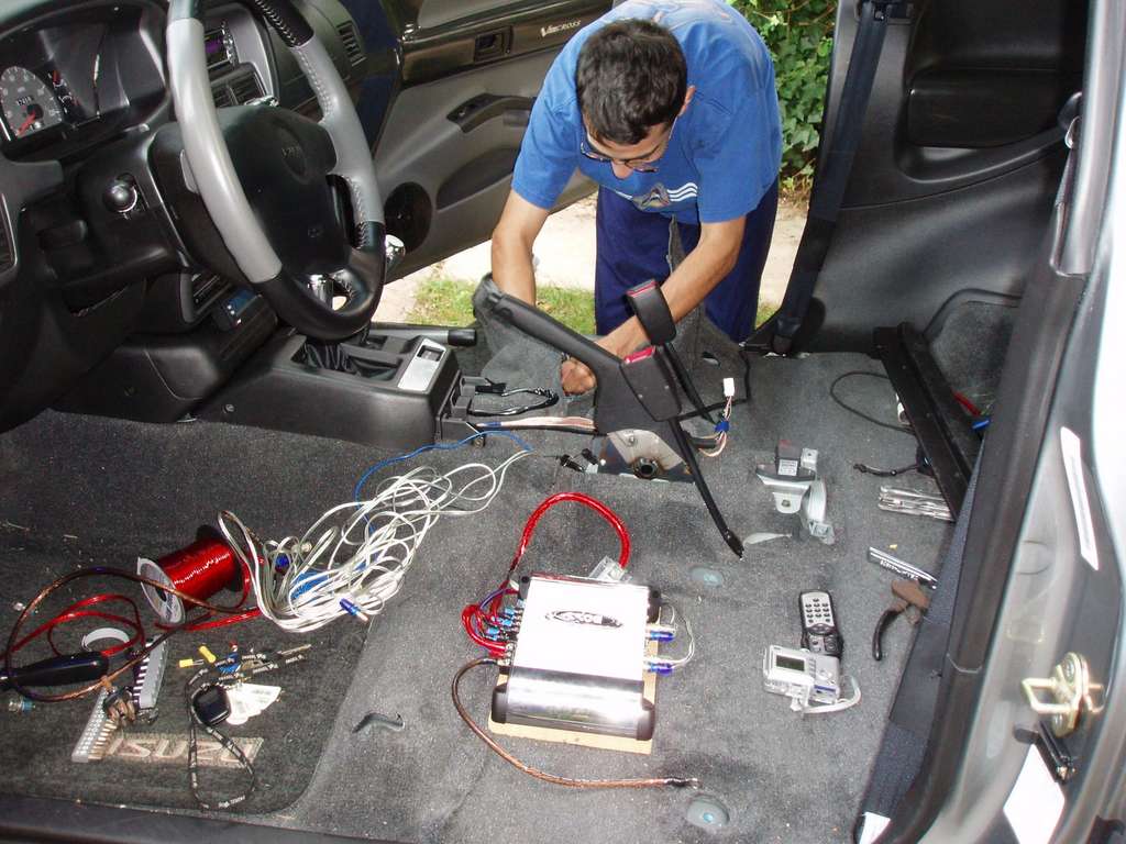

    got some pics of the progress on the audio system
    front speakers 6.5"

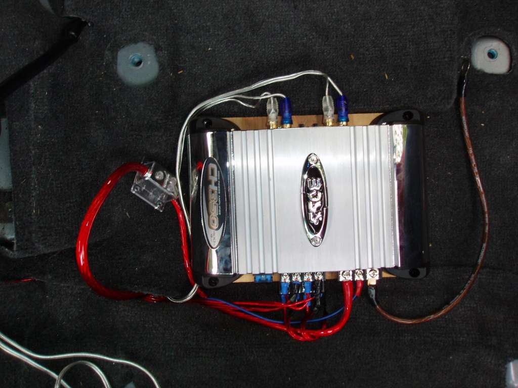

    4 channel 400 watt amp located under drivers seat powers all speakers in stock locations

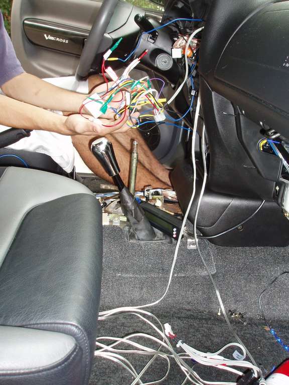

    wiring the DVD player.. wires EVERYWHERE.. got very tedious.. but its all back together now (except the cd changer slot.. monitor comes tomorrow)
