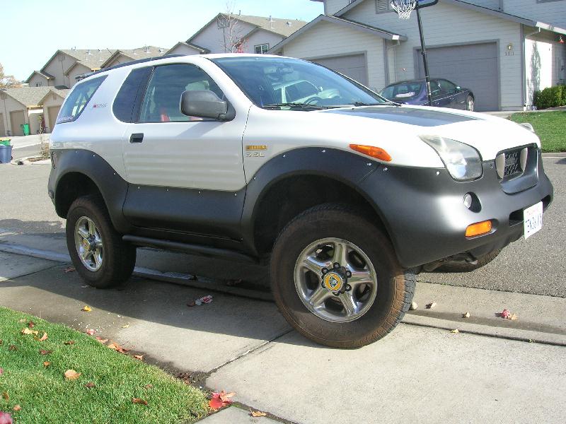

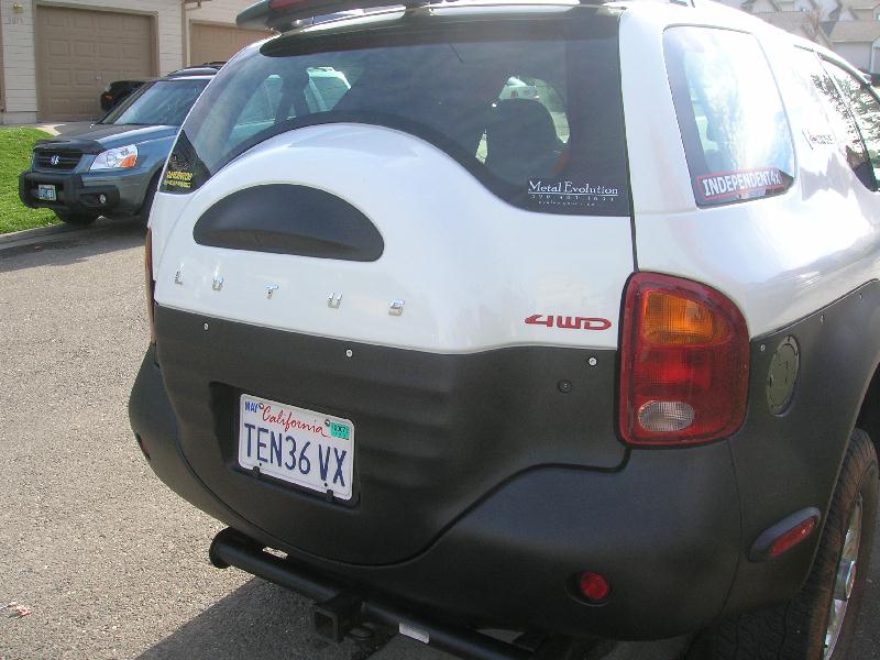

I painted my cladding today with flexible bumper paint.
I didn't like the faded plastic look.
While I had the bolts out I sprayed them silver. (not sure if I like them silver)
Last week I painted the calipers and debadged.
Here is the Before:

Ooooo, I likey!![]()
Anita
2000 Ebony #263
AnitaProtich.com
Looks very nice, The Cladding bolts look good also.![]()
Wow, looks great!
I assume you took all cladding off before you painted, did't you?
How much did it cost to you?
very nice.............quick how-to right up? Which specific paint?
wow.. looks very nice.. please share the details!

Looks good
Can you please make a follow up post in a few months so we can see how well this holds up to the elements and every day use.
Live Free or DIE!
very nice!Is there any problem with texture variations?
Steve
Looks "good"?! I think it looks GREAT!!!
Well, in the pictures, anyway - I almost can't believe a rattlecan job like that would look as good in person. I'm not doubting - I'm just expressing my shock at how sharp it looks!
And please keep the bolts as they are - that contrast was the first thing I noticed and I was stunned by the look! It's a sharp counterpoint to the black, with a classy look, and it ties the remaining chrome bits together visually.
WELL DONE!!!
Looks great! Good job!
Daniel
Nice keep us posted on how it holds up... do you need to treat it with any cladding products or is it good to go and will not fade or streak?
One thing looks like you missed two bolts on the font by the grill.
Good work.
-Dave
Looks fantastic! Thanks for the write up.
Peace.
P.S.
Did you have some minor nicks and scrapes to cover up? Did it cover them up completely or is it still noticeable?
I'm impressed....I love the 100% black out look...now all you need to do is debadge and order up some clear corners...
That's it!! To hell with the paint booth-I'm closing it down and selling it. I like the contrasting bolts
