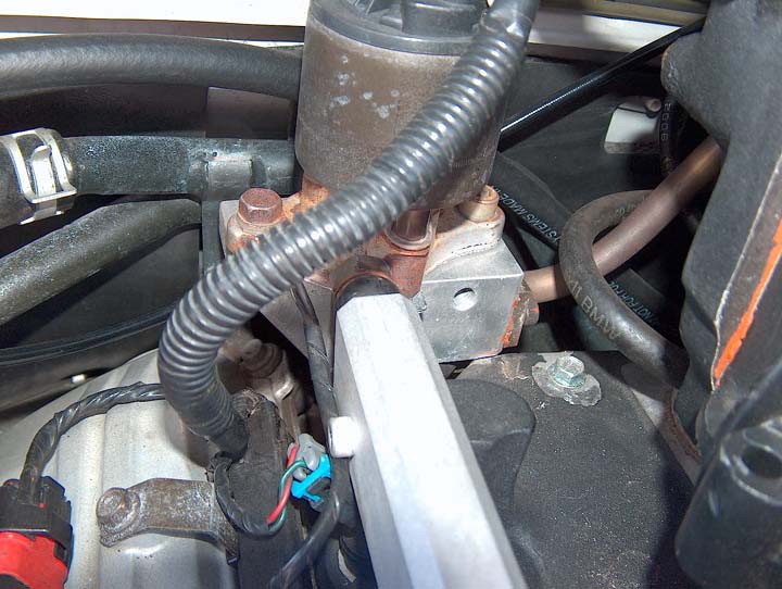

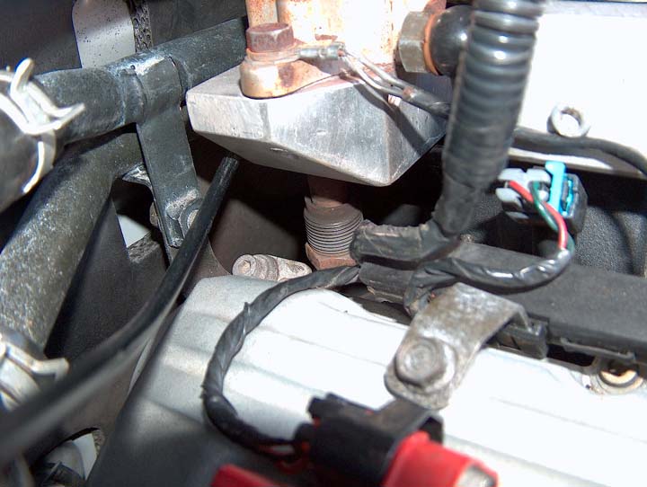

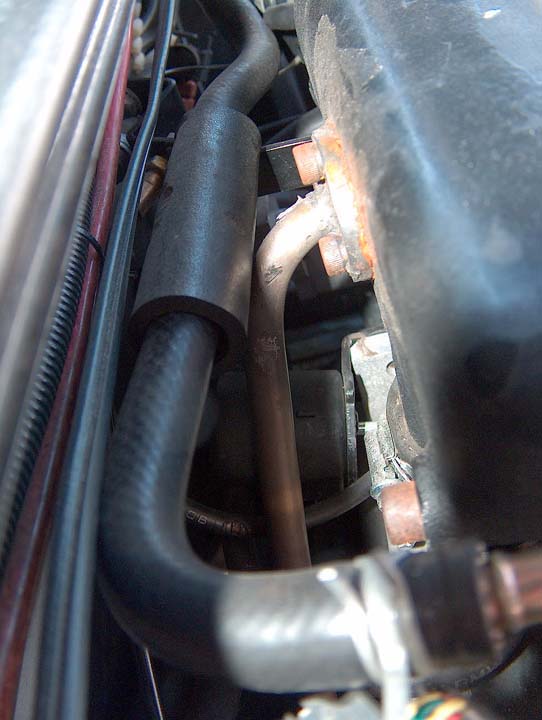

I've used a regular 10" 22mm crescent wrench to r&r that EGR nut before without issues.  It just takes a long time because it only gives you about and eighth of a turn, and you've got to flip the wrench over halfway through in order to get it to turn enough to get the wrench back on.  Then again, this is on a stock '99 VX (not s/c).
