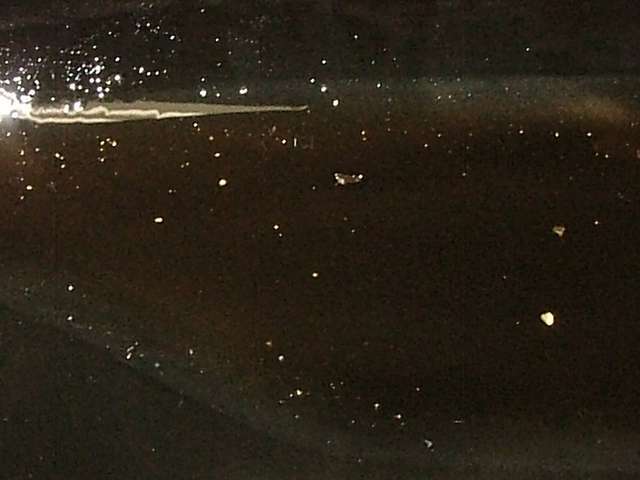

Got the front transaxle out today. Pulled the sump pan ... eww. There are brass _flakes_ in there. It looks like the engine was recently reassembled, so I'm hoping it's break-in debris. I got all the bolts out of the oil pan (what a pain), but the pan won't come off. I guess it's not the source of the leak

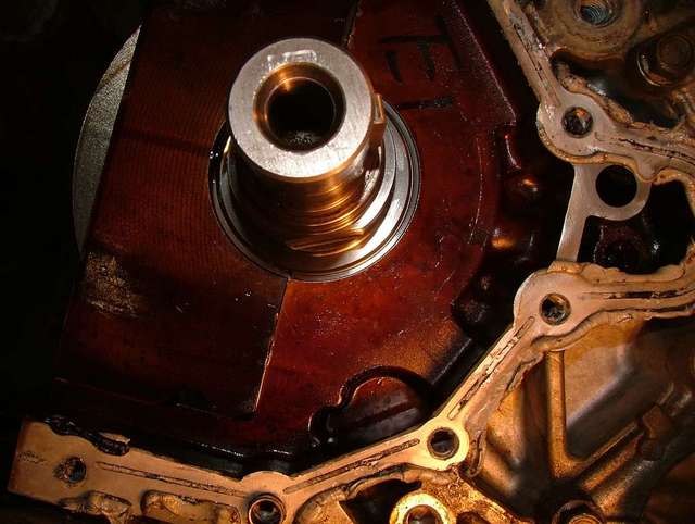

Looks like I do have to pull the pan ... was searching for parts and found this:

Here is the picture of the junk I found in the sump pan:
My current guess is that's break-in junk. I hope. Second opinions?

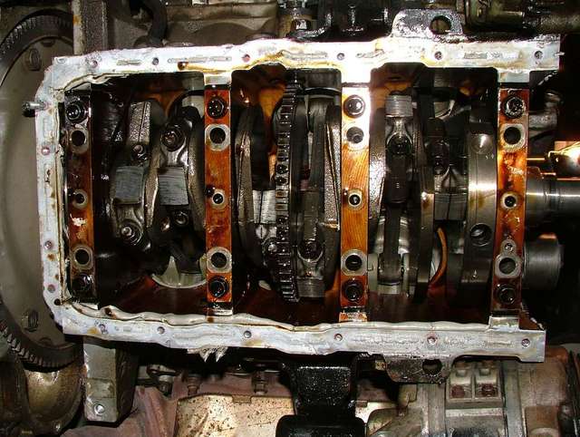

Here are some pictures of the bottom end of the engine. I now know why the pan has to come off the replace the oil pump. I'm not sure why the previous person working on it didn't do that step - I always replace oil pumps when replacing bearings. I don't think they replaced the seals around the pump either, which is probably where my oil leak came from.
Behold:
I hope this isn't a hackjob where the bearings will go again soon if they had spun in the block. Maybe they started knocking and the owner fixed it right away, but there's no evidence of any of the rods being new (all have what appear to be scars for being knocked off with a hammer).
