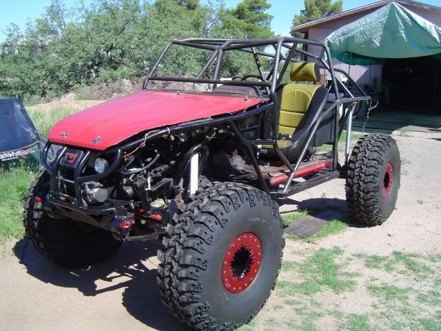

    Triathlete, I've been MIA, but I'm back! We've been absolutely slammed with projects, which is great! We just finished doing a truggy conversion on an 83 toyota. Removed the cab and frame from cab back, 4 linked and 16" Fox Airshox in the rear, flat belly conversion with custom skid plate, fuel cell, LED brake lights, headlights, hydro assist steering, put a bunch of DOM tubing on it and mounted 42" IROK tires on our own Flame Beadlock kits. Took us 13 weekends. The truck came in as a complete truck with only a mild lift and 35's. Pic below.
    I can build you a set at the same time as Biju's if you would like. Would you like that 4 link SAS with your front and rear bumpers ?

    I don't wanna be the guinea pig, but I'd LOVE to see somebody do that to a VX!!! (pic above). Full cage?... nice.

    Those red beadlocks would look sweet on my VX!

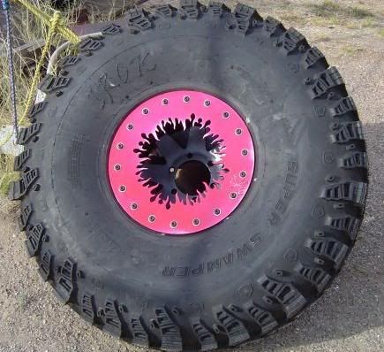

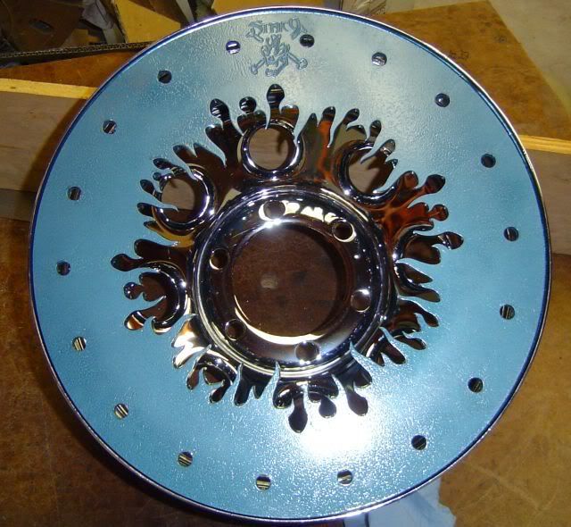

    We're making these for ANY size rims with a few different styles. They can be a full DIY beadlock kit including inner and out rings with all grade 8 hardware and button head capscrews. Or they can be rock rings, where you just weld the outer to your rim. Aluminum kits are an option. Here are a few examples of the designs, but more to come!
