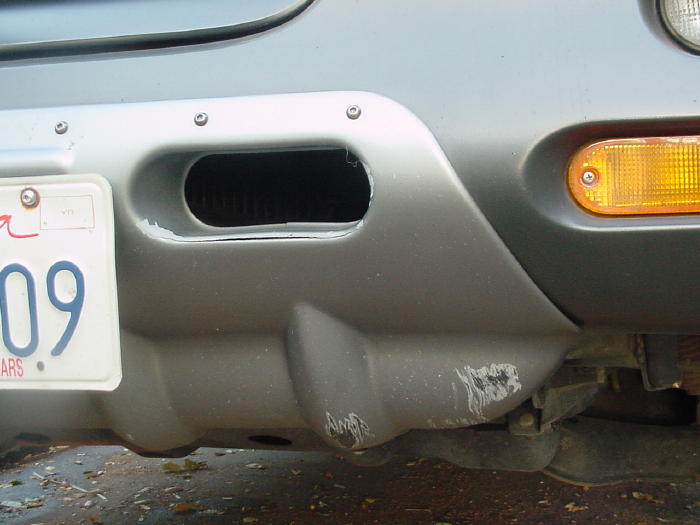

    Hi all,
    I have been wanting to do a few modifications to my VX for a long time now, but have been strapped because of our up coming wedding.
    So, after building a couple VX models, I have decided to try an experiment on my VX. Many will laugh... I know.
    The biggest question I'll pose to you is...
    "skid plate, or not a skid plate... that is the question..."
    Now... take a look at the pictures.................
    Let's just say... I saved myself $300 and you can only tell if you are up close and know what you are looking for!
    hehehehe...
    Let me know what you think!

    Looks good I had considered that same method - any problem with the paint adhering? What type paint did you use - and I assume you just drilled some screws into the cladding to finish the look at the top??

    Hmm...Is that skidplate actually "painted" on there? From a distance...yeah, i woulda never noticed it....Wow, good stuff! Not really practical...but at least you've got the look!

    Wink Yes, I painted it!
    The cladding required a good scrubbing with Laquer Thinner to remove all the shining products...
    But I just used a Rustoleum Metalic spray (Aluminum)... and used many coats of clear gloss lacquer (for protection). Being that it is relatively cold (58 deg), I had to use a portable heater (radar dish type) to cook the paint between coats. I used a self-drilling polished-looking set of screws for the top. I tried my best to mimic the design of the VX02 look that many have...
    I figured.. well, what good does $300 of fiberglass and paint do against a rock?... not much.
    So, why not spend $10 on paints and put my art major to work, have the look I wanted, and save some bucks!
    The nice thing is, if I want the real thing later, I can just mount it over the paint.
    I'm thinking about doing the rear skid plate next! LOL!

    Quote Originally Posted by SilverBullet75
    Quick question... I'm looking for a product that will remove products but not dissolve or discolor the cladding. Does Lacquer Thinner affect the plastic at all?
    Thanks!
    Steve

    Yes it does... it will fade it. I don't recommend it.
    You may try Castrol SuperClean (purple)... it does pretty well.

    I can't say this from experience, but I've heard from more than a few others, that Simple Green works well...then maybe a "once over" with rubbing alcohol.
    Looks good Silver Bullet, I've done similar front & rear, but since the fall Badlands meet it needs some touch up...oh well.
