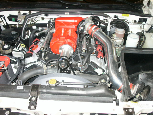

    I'm also using the "Jayfotos" intake with a K&N filter inside a heavily modded stock air box.
    Also, I have run a length of 3" alum. ducting through the center of the c/f intake w/ insulation packed around it (between the inner wall of the c/f part & the alum. ducting) to reduce intake temp.
    Also, have fabbed up a heatshield between the intake & the engine.

    Heat shield made from home depot trash can.

    Sweet, thanks for the different ideas. Any opinions on performance differences?
    2001 Proton VX 0790
    801
    The difference is quite noticable, especially when its cold out. The stock airbox chokes out performance one the non-SC cars, ans worse on the SC because of the even greater air demand.
    Put the biggest cone filter you can find on, and make some sort of heat shield.

    This was how I made the cold air intake and box.
