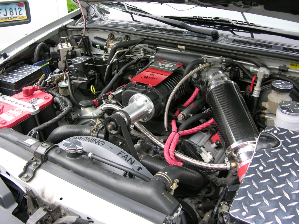

    Out of the peeps with s/c's how many have a cold intake added? And do you have any pics/brands that you recommend. I still have the intake running to the original air box. Also would a performance difference likely be noticed?

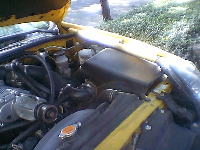

    I'm also using the "Jayfotos" intake with a K&N filter inside a heavily modded stock air box.
    Also, I have run a length of 3" alum. ducting through the center of the c/f intake w/ insulation packed around it (between the inner wall of the c/f part & the alum. ducting) to reduce intake temp.
    Also, have fabbed up a heatshield between the intake & the engine.

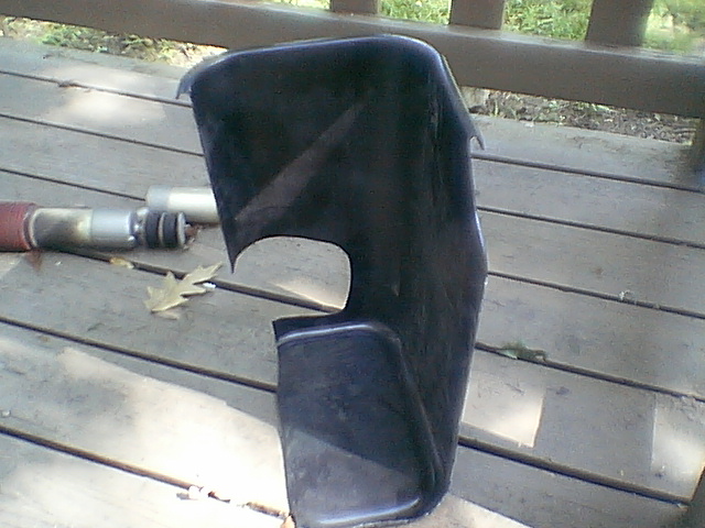

    Heat shield made from home depot trash can.
