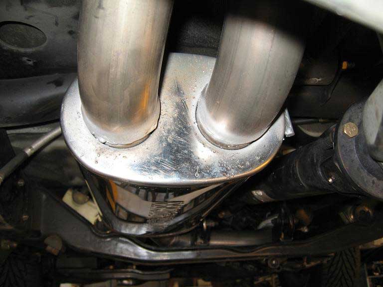

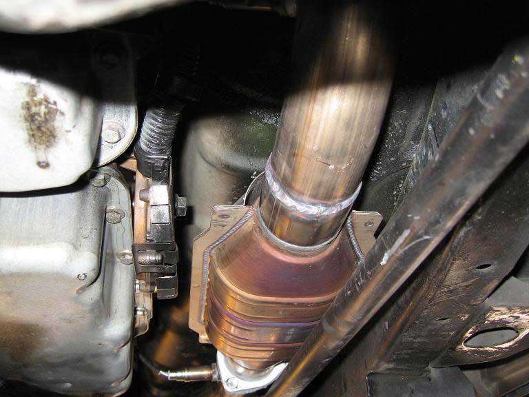

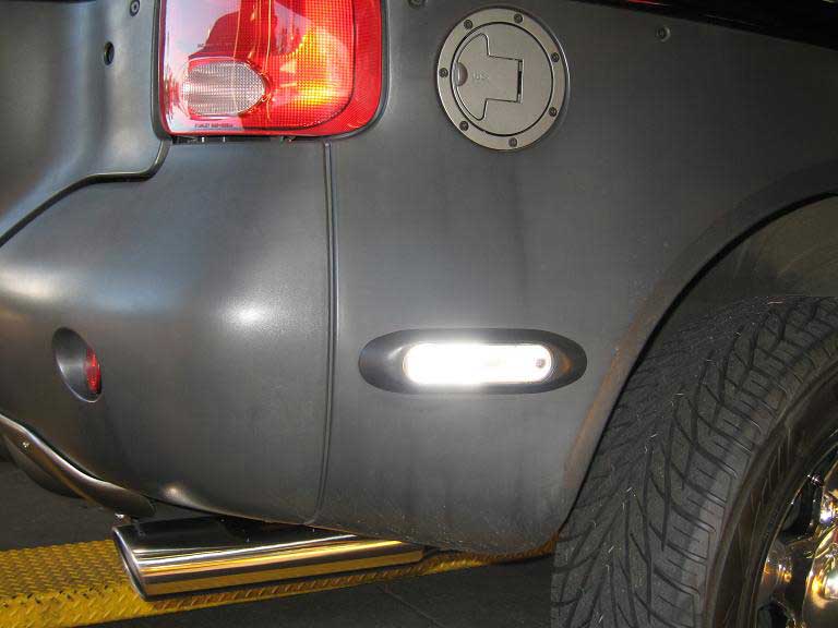

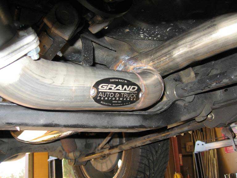

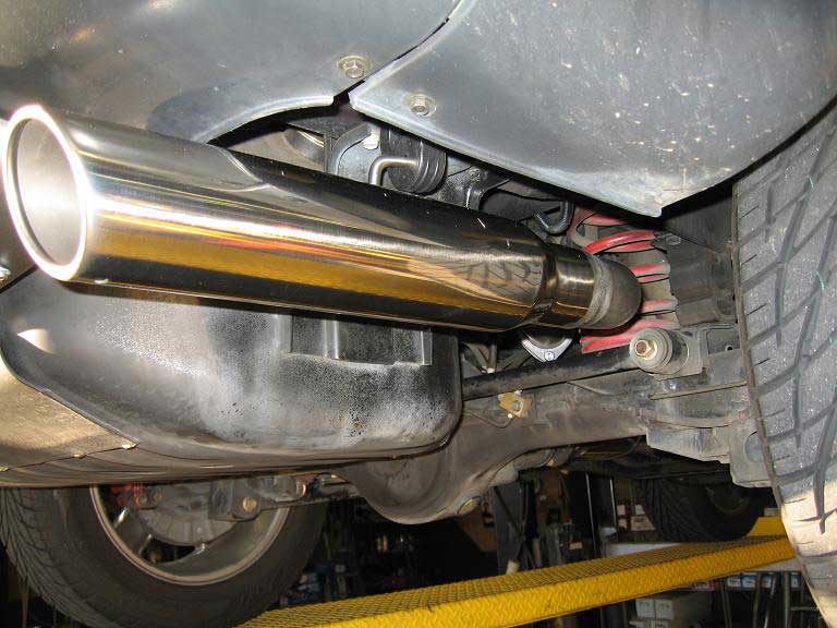

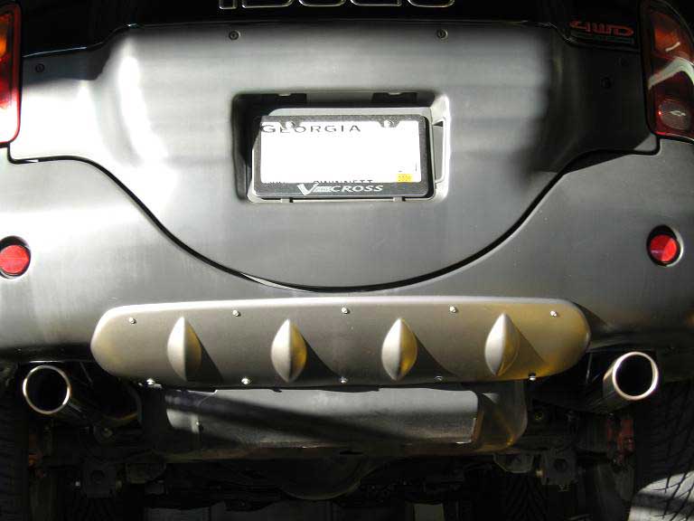

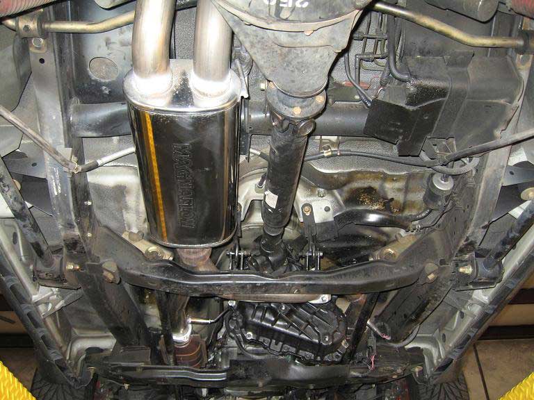

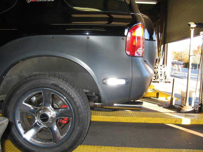

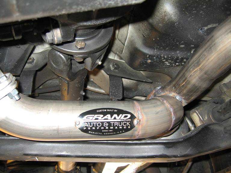

    Just got back... THANK YOU Todd, and the rest at Grand Muffler you guys did an outstanding job on the new exhaust. Sounds mean need to go back to the dyno to mess with the FMU now that I have an exhaust working correctly. I look forward to letting it break in and mellow out a bit. Whew this is what I wanted from the get go.
    Todd was showing me that on the old pipes the other shop welded they did not even weld around to the top so it was just sitting open!
    Feels strong and sound nice! Great craftsmanship, check out the pics...

    More pics:
    Jan 2005
    952
    That is outstanding workmanship -truly, they should be proud. I like the custom badge, it's a nice touch and shows that they'll stand behind their work. Whatever you paid, I'm certain that it was well worth it.

    MUCH better! Wow, that's night and day! Remember it will take about 1000 miles before the sound "matures" completely, too... so it will only get better with time!
