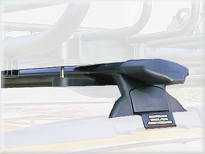

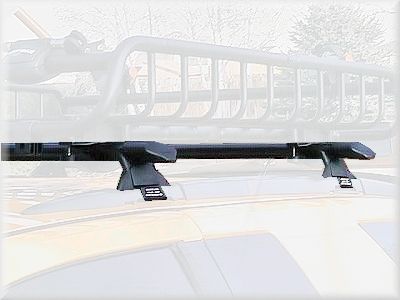

    OEM Roof Rack
    OEM "Wing Bar" close up
    Load Warrior Cargo Basket

    I was at the store today taking measurements of the both the Yakima LoadWarrior and the Thule M.O.A.B. it does not appear that the Yakima LoadWarrior's mounting brackets line up with the approximate 28 1/2" (on center) spacing of the VX roof Rack's. And the mounting brackets can only be possitioned inbetween the basket rods which is about every 4 1/4". Did you have to make modifications inorder for the LoadWarrior's mounting brackets to allign with the roof rack?
