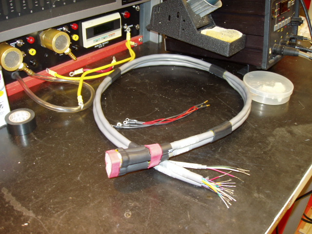

    This was the cable that I built to interface to the TOD:

    TOD interface cable, ready to go.

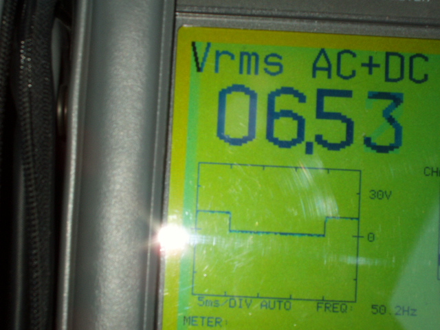

    This is a scope shot taken at idle, in Neutral (transmission). Notice the pulse width.
    At 60mph (on ice) in 15% mode:
    Random scope shot:
