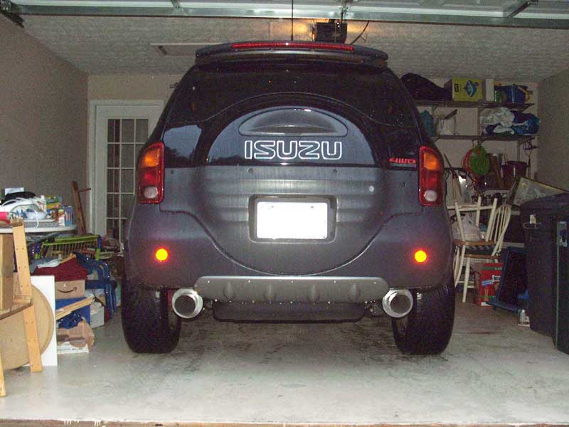

Picked her up from the shop lastnight...
The system looks amazing! It is a new 2.5 exhaust from the downpipes into new bungs for all the O2 sensors, high flow Mangaflow cats, with an H pipe all the way back to 2 massive Manganflow mufflers with 4inch slanted cut tips.
At startup and cruising it sounds bad azz, kinda like a grand national with an exhaust! but as soon as you floor it is way to LOUD, New resonators for each side are getting installed Tues. Feel much stronger - more air in much more air out nowWe are thinking 10-15 more HP when i go back and Dyno it, fingers crossed. This was an expensive mod, but the craftsmanship it top notch, great welds no rattling and mean looking and sounding.

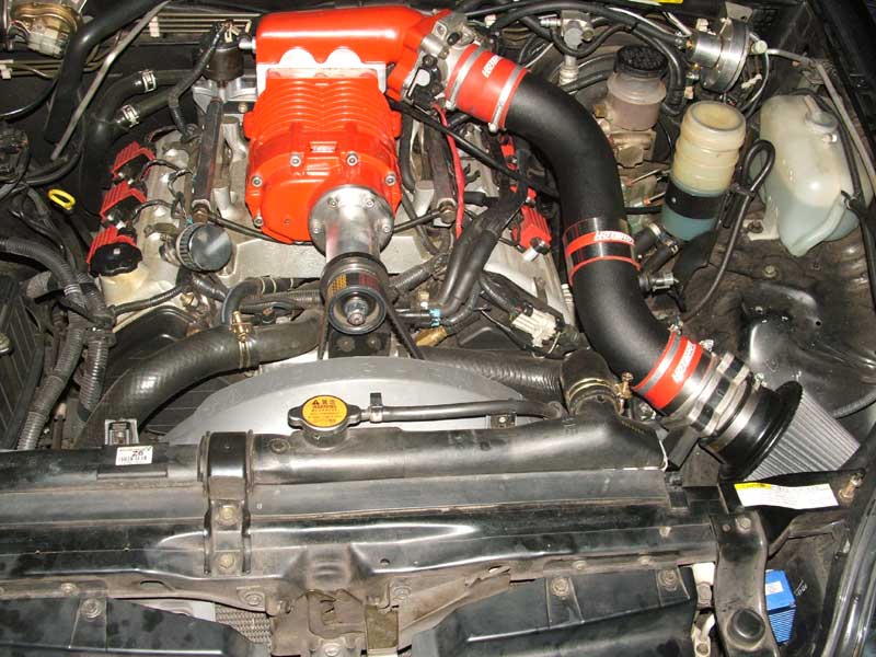

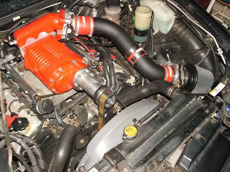

Also powder-coated my intake crinkle black to help with keeping the heat down and added a new BBK air filter and moved the FMU around.
Switched from Mobile 1 Synthetics 10w30 to AMSOIL 5w30 too.
We are thinking off adding water injection and machining the larger pulley down to run more boost (7psi) hopefully.
I snapped some pics, sorry it is crappy out today, will take some under the VX when we put on the resonators Tuesday.
