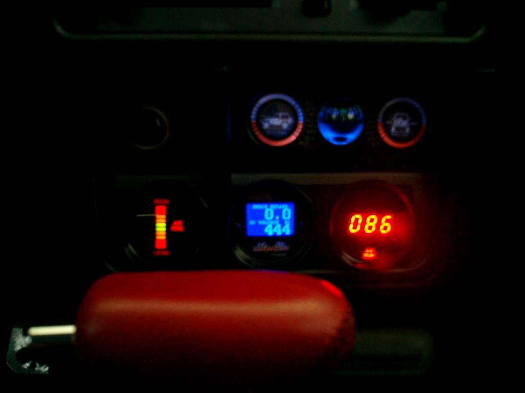

    It's looking more like a spaceship now.... the ashtray now has the inclinomter with blue LED, the bottom DIN location has 3 gauges: air/fuel, ODB2, and in-cabin air temp. The fuzzy hole has the digital clock.
    For your seeing pleasure

    Thanks for all the compliments. You can get the inclinometer from jcwhitney, they only have one on the website so should be easy to find. I performed a little surgery on it by installing two 194 blue LEDs and hooking it up to the light switch so it would turn on with the dash light. The LED clock was also purchased from jcwhitney. The ODB2 scan gauge was purchased from Tone and it came within 2-3 days.

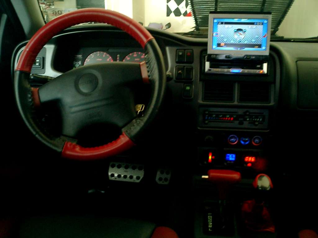

    I'll try to take a pic of the inclinometer during the day so you guys can see clearly how it's fitted in there. Will have to wait until this weekend since it's already dark by the time I get off work.
    Basically, I removed the ashtray + bracket and squeezed that thing in there. I also had to create a little bracket to hold it in there (not hard to do). The inclinometer came without lighting. I took it apart (very easy), drilled a hole in the back and put two blue LEDs in it, and wired to the instrument on/off circuit. I soldered the LED's directly to the wires, no LED base was used.
    If you guys are in Austin, I'll be more than happy to help with the installation or just email and I'll help anyway I can.

    Day time pics as requested....
