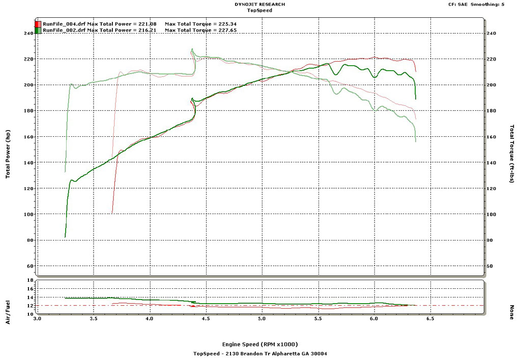

    New Dyno app set up for Tues. Taking the day off to get to the stores early to get and Xbox360 them make my way up to the dyno and mess more with the FMU, going to disconnect the vacuum line to negate the FMU to get a base run and go from there.
    '99 SC Ebony #1961
    1,559
    Thumbs down
    Well I did not score an Xbox360 (anyone got one they want to sell me?)... but I did get to the dyno today... we disconnected the vacuum line and that got rid of the FMU and the air/fuel curve was fixed. Gained a whopping 4.87hp over the PowerVault Generation one cartback but I lost 2.31TQ.
    Not too happy it was allot of money and time for under 5hp and it is still too loud (in my opinion). Got an app with exhaust shop the dyno place recommends here in the ATL, going to see if this duals are flowing right and if we can quite it down any.
    here is the new dyno scan... almost done with modding the CrapaCROSS it is getting frustrating.
