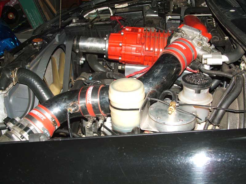

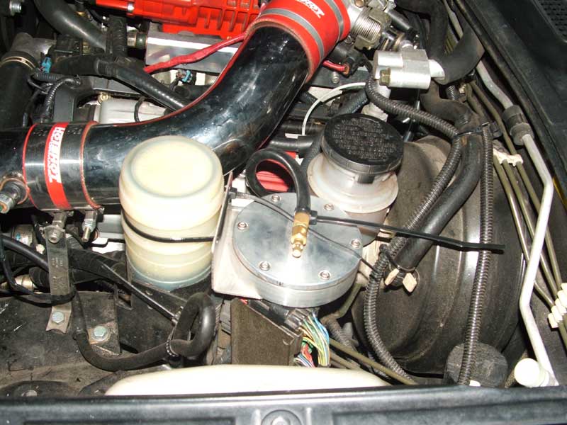

    Some photos of the unit, pardon my dirty azz engine, it is getting cleaned soon.
    In a nutshell, the FMU adjusts fuel pressure when the boost comes on, regulating it at normal levels during normal operation and dramatically increasing it on demand. It is purely a mechanical device, using different sized disks inside the unit to alter the pressure at which the FMU takes effect. This makes it relatively easy to install and adjust.
    FMU allows the car to run normally on a small injector, but can also increase the rail pressure under boost which, in turn, forces more fuel through the same size orifice. The fuel that the FMU adds has a direct relationship to the boost pressure.
    The Pressure ratio determines how much the fuel pressure is increased per psi of boost pressure. A 12:1 FMU, for example, will increase fuel pressure by 12 psi per psi of boost. It is typically recommended that a 10:1 or 12:1 FMU be used in order to ensure that the A/F mix will not be lean.

    Noice..just make a bracket for it now, can't have something like that bouncin around with zipties.
    MMMM...Alien technology...flying saucer :homer:
    In all seriousness, Looking forward to seeing the numbers/curve.Also, was the part itself (w/o labor) co$tly?,instalation, plug & play or complex?

    What you have there is a Vortech FMU
    or 10:1 rising rate fuel presure regulator. It's a handy little tool for leveling out fuel managment for low boost aplications. a worth while upgrade if your supercharged to keep fuel delivery smooth.
    http://www.capa.com.au/vortech_fuel.htm
    You got a good deal if he gave it to you for 200.
