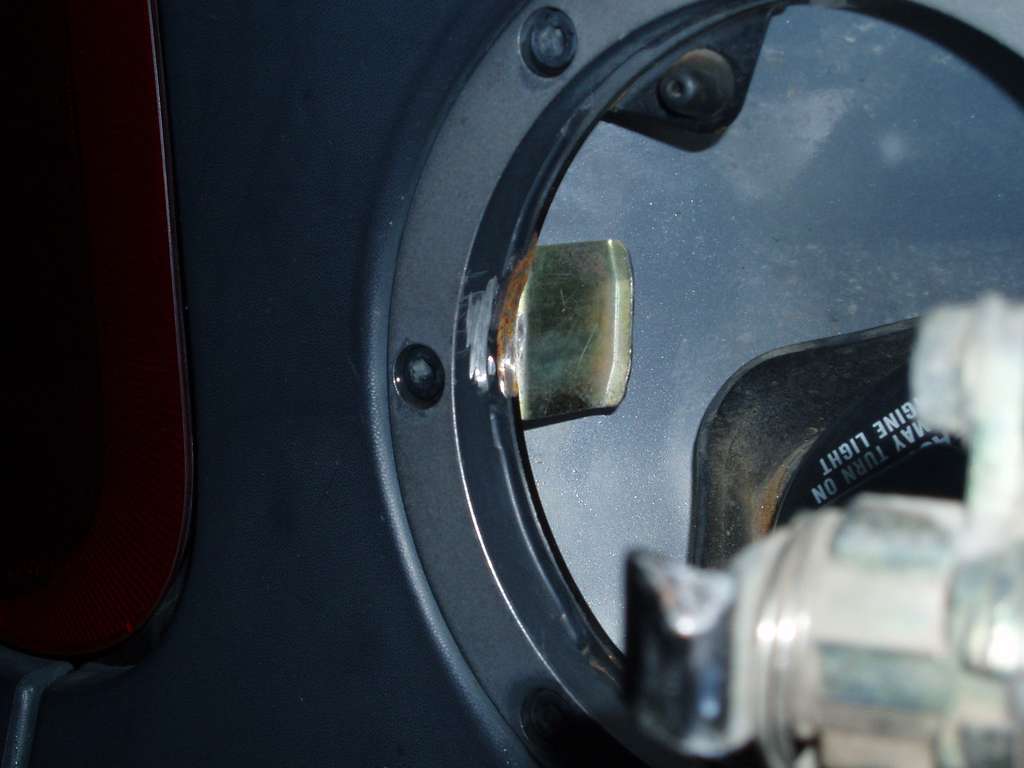

I could not close mine without the key, so when I read that half of the owners could, I studied the latch and found that it would not push pass the inner metal ring (part #8 in previous quote). So I used a Dremel to grind almost an 1/8th of an inch off the edge. (only in the path of the latch)Originally Posted by mbeach
I also had to remove a tiny bit off the plastic coated latch upper corner, (right where it bends) to ease it passing through the outer ring hinge plate (part #6 in previous quote).
NOW IT'S SMOOTH AS BUTTER!!!!
Gringing seems like way overkill...I just rebent my latch tab with my finger (you can have it either way - key or no key).

If you look ( at the above picture) you can see the latch scratches the outer ring on "my" door. the inner ring sticks out into the path over an 1/8th of an inch more, if you bent the latch that much you would not have any left, if you do not like grinding, you may try loosening all the ring bolts and try moving the inner ring rearward hoping that there is enough play in the holes to do so. the latch tab springs out of the way, and only needs to be bent in enough to hold the tip of the latch. The grinding doesn't show but you could file and paint to protect from rust. I will
