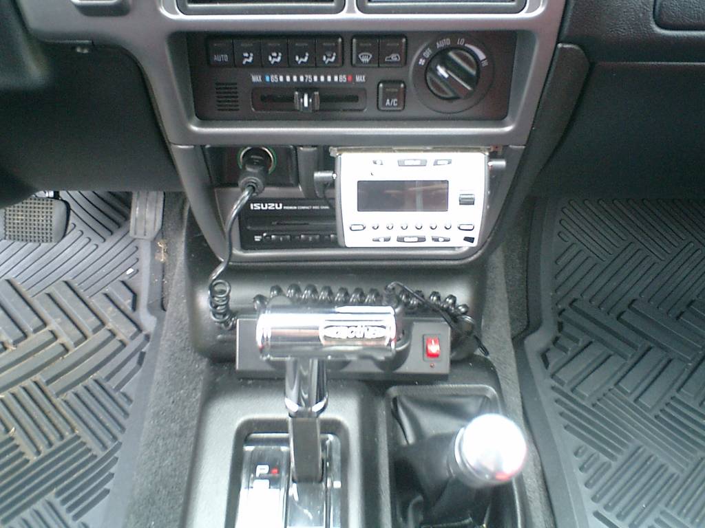

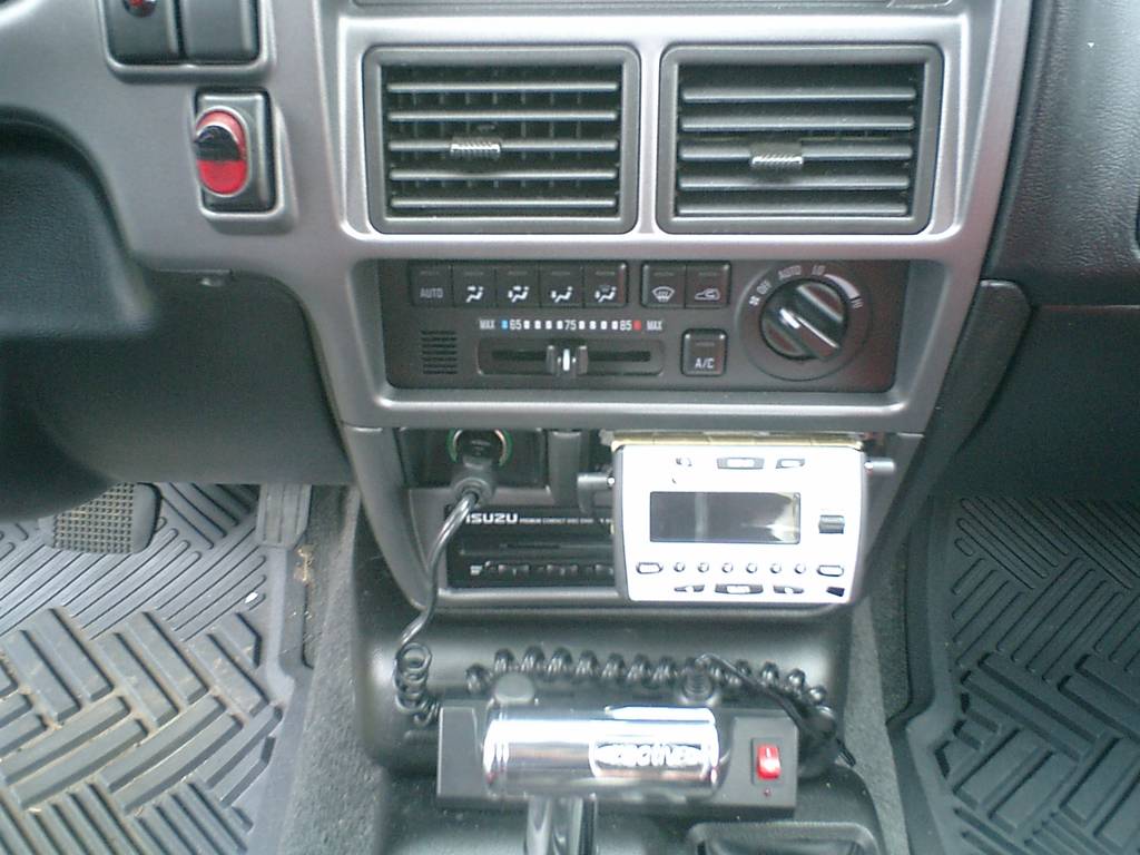

    It turns out that the area that the window defroster vents are in at the front of the dash is sheet metal and the magnetic antenna mounts perfectly there with the cable run along the edge of the front of the dash. I have a sirius Starmate that I mounted in the ashtray (removed) opening on a plate I fabricated. This allows me to remove it easily for use in my other car.
