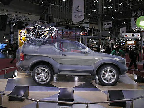

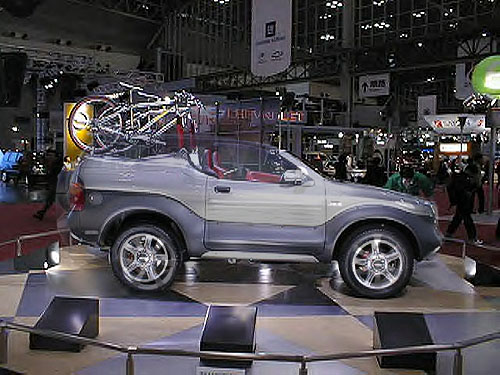

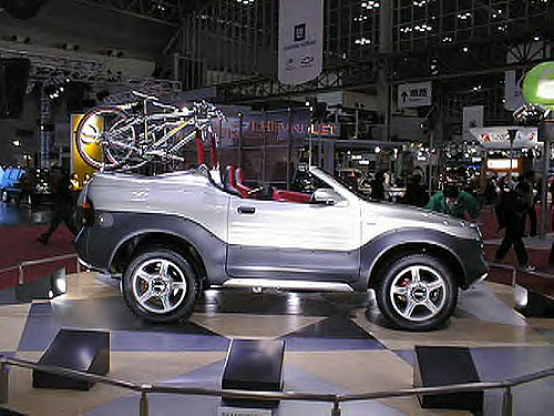

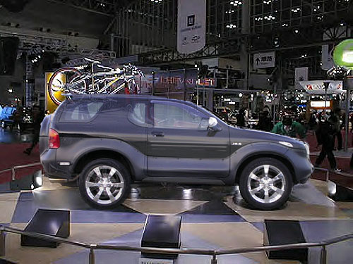

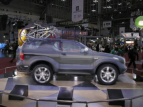

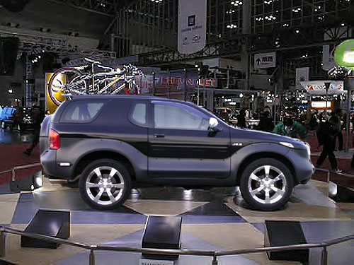

    I believe that Isuzu did not change the angle of the windshield. Rather, they just shortened the total length of the windshield perhaps to not only lighten up the load pressure on the pillars, but also to minimize the wind drag as well. As you can see, for demonstrative purposes, the following photos showing the windshield remaining the same angle except for it's shortened length on the O2. I know that the angle of the photos of each vehicle slightly differs. But, you get the point.
