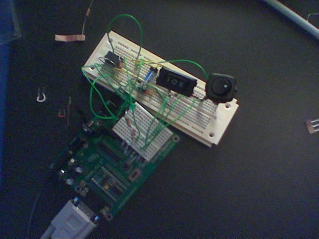

    The newer system is almost done, I'm working on the finishing touches for the basic stamp. It will control startup/shutdown along with auto adustment of the backlight luminosity for the newer LCD display (which is the latest version of the Xenarc). I actually took a picture of that!
