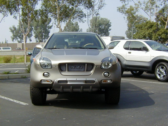

Regarding duplicating your fangs, vacuum-forming probably wouldn't work or be the best solution. One, because you'd have to have the fangs already pre-bent to the same curve as found on the surface of the insert. Since a facuum-formed part is pretty much fixed in its shape. Also attaching it to the insert would be difficult since you would have a hollow cavity and no real surface area to attach the double-sided tape.
What I intend is to create silicone rubber negative molds from the ABS machined fangs that I have currently. Once the molds are cured, you would have a negative impression of the fangs in the silicone mold. Simply mix a 2-part resin such as "fast-cast" which is quite durable, sandable, paintable, and will cure in minutes and pour or inject into your silicone mold. Once cured and hardened, pop the part out and hand finish to the level of painting. The whole process is quite easy and quick, except for the painting process. One quick note, it helps to have a vacuum-chamber to "de-gas" your silicone mixture to force all the bubbles out otherwise you'll end up with a part with a lot of bubble pits throughout your part which you'll have to remedy with bondo later.
