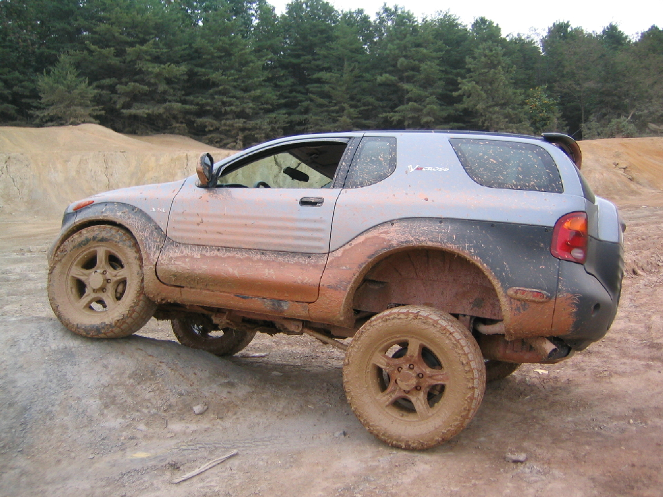

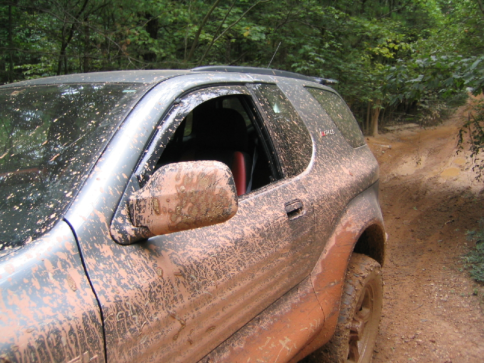

No problems here 285/60/18s. I've been off-roading with them and had NO clearance problems at all (just the minor trim on the front). They did a great job, only got stuck once in a nasty mud hole where I bottomed out. I have a picture of the "other side" of this shot if you want to see how they have plenty of room even inside the wheel well.
http://www.vehicross.info/gallery/da...x-mud-flex.jpg
Jay
For you guys with STOCK wheels and the 285/60/18's-How far do the tires stick out from the wheelwell?
Not much at all. It is nearly even with the wheelwell. Not a great pic, but you can see here they don't stick out much at all.
Jay

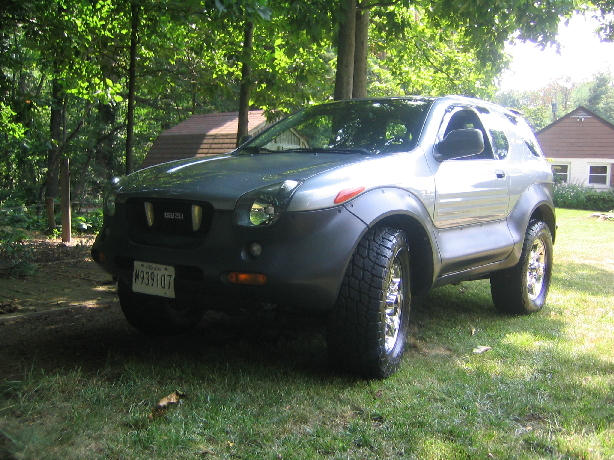

Man ,when they rolled out those tires I didn't think they
would fit. Got one of front tires on for a test fit. No problem!
Looks like it should of came with those tires! Fill out the
wheel wells, and from the back and front they look wide.
VX looks like I need to find some mud.
THANKS STEVE
