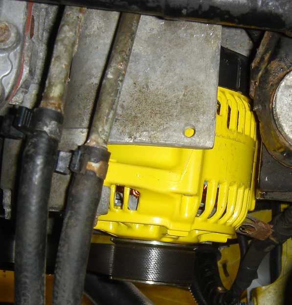

    I purchased this from Rickster quite a while ago, but never got around to installing it till now. Its a fairly easy bolt on installation, done from below. The trans cooler lines do not need to be disconnected. I would advise disconnecting the battery though.
    Idle voltage: 14.3V, so no worries about charging at idle. Some high amp alternators don't charge till about 1500-2000rpm.
