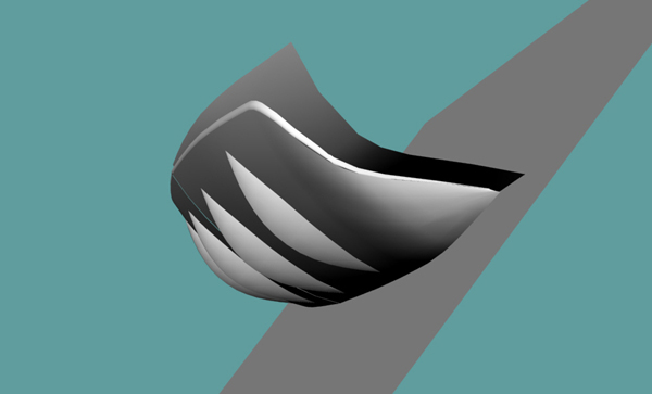

    Just thought to update those still wondering whether I'm really serious about creating the rear skidplate to compliment the front. Here's the CAD rendered images of what's to become the mold to produce the plate. This is about 90% complete as I'm finalizing the hole mounting placement locations along with the walls of the mold itself. But, the images will show you some indication of what's to come assuming it passes the test fit and look of the 1st prototype.
    And once this part is released, I hope to follow shortly, with the sides to complete the entire kit.

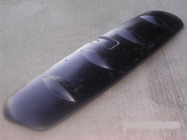

    Had the prototype mold machined out and formed the first test fit prototype rear plate. Results are awesome!!! I also installed Tone's hitch and installed the plate afterwards. Looks great with both components. However, I need to modify slightly the slot where the hitch is applied. Other than that, the plate fits very nicely and really compliments the rear as well. I'll post pics when I get a chance.

    Here's the final CAD model before submitting to the machinist.

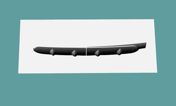

    This is the foam mold machined in two halves at a time.
    This is after the first vacuum-form over the prototype:
    After all the excess flash material trimmed off to the profile line of the plate.
    Preliminary mounting and test fit of the plate before the hitch installation.

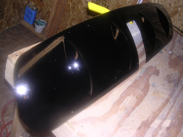

    Here's a pic of the plate painted in Black after the modifying a slot opening for the hitch clearance beforehand.

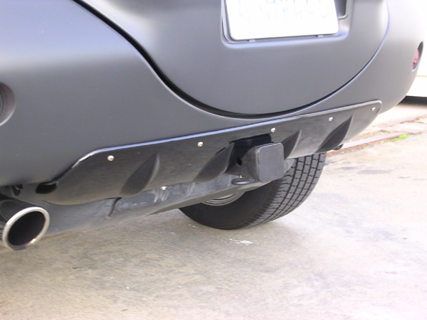

    After the hitch installation, the rear plate is finished and mounted using the stock bottom screw mounts only.

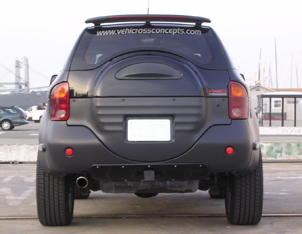

    A full rear view of the plate with the hitch combo.

    Ron, looks great - I can't wait till it's ready. One thing though, it looks like the opening fot the hitch is much too large. It may be just the pictures; but on the prototype, the area designed for cutout looks MUCH smaller than the area cutout shown on the pic with the hitch installed. On that picture, it looks like the opening cut out is much larger than required to clear the hitch.
    I know when I was installing my hitch, I was concerned about how the cladding was going to look cut out around the hitch. I did it a little at a time until it barely cleared, and you couldn't tell that it had been cut, because of the close fit to the hitch - it looks factory. Again, the picture may be misleading, but it looks like there is a lot of open area around the hitch on the installed plate, which makes it look like an afterthought. The depressed area on the shot before hitch install looks about right.

    The opening slot on the "just painted" pic is the actual opening slot to accommodate the hitch in place. Originally, I was going by what Tone's instruction of cutting out a 4-4.25" long by 2.5" wide cut-out which I found out to be only applicable to the cladding itself and not anything else over it. It's kinda hard to explain, but I believe because the curvature of the skidplate over the cladding combined with the angle placement of the hitch's square tubing, resulted in lengthening the slot in order to have the screw holes match up with the cladding mount holes. Don't know if that makes much sense or not. But while I kept fitting the plate over the hitch, I found myself trimming off more and more of the slot and thus the longer slot than the cad model. I'd say about 2.5" longer. Anyway, I think you may have mistaken the reflection of the hitch on a glossy black surface as part of the opening which it's not. The slot is shown as it is in the "just painted" pic. It's also squared off at the top to fit flushed along the top surface of the square tubing of the hitch. Believe me, the slot opening is not noticeable unless your directly underneath the vehicle.
    I plan to re-adjust the slot on the CAD model to reflect the measurements of the test model. If you look closely to one pic, you'll see that the plate surface actually cover the 1/2" locking pin hole partially. This of course will prevent locking any kind of hitch accessory to the hitch which does no one any good. I plan to insert either a "trench" detail of some sort to allow a pin to be snaked into the hole or maybe another rectangular slot opening may be needed as a last resort. Either way, I'll be purchasing a hitch accessory with a locking pin to test it.
