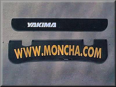

    Ron, Newthings, myself and a few others have developed our own "spoiler" for the rack. Newthings and I have a Yakima Load Warrior but the concept is the same. The Load warrior comes with it's own spoiler but, I didn't care for the small size.
    Ron's site
    Newthings' custom spoiler
    My custom spoiler compared to original Yak
    See the whole thing
