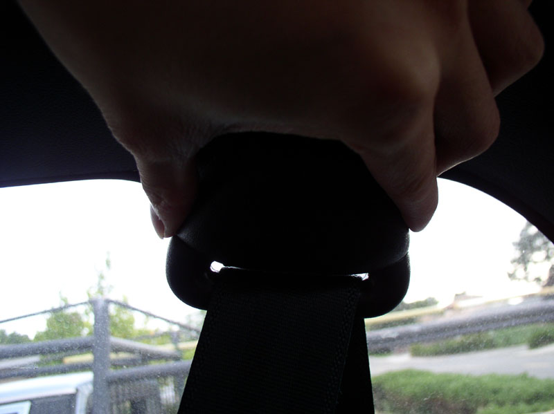

Went to replace in back speakers today, followed the direction on how to take off the Side quarter panel...got everything but the F*#$ seat belt!!!

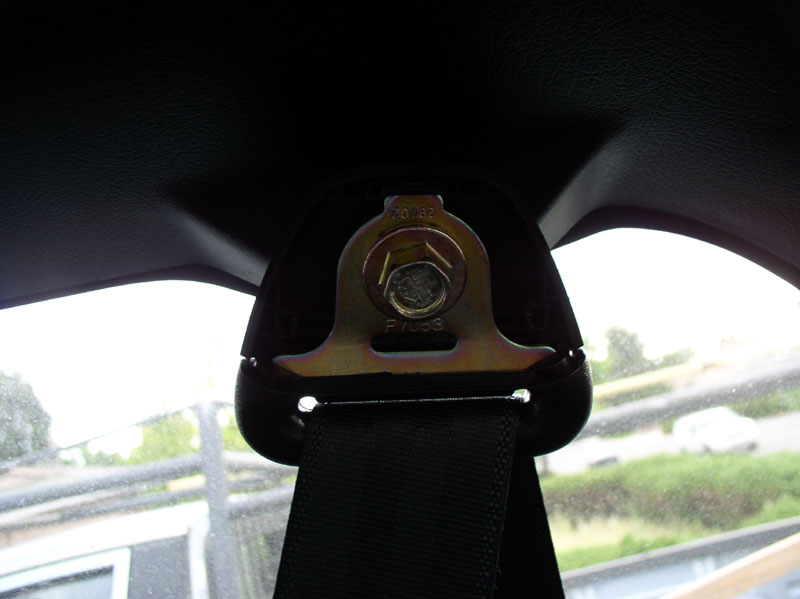

How to you remove the seat belt (top part), the part that sides up and down for the front seat belts?
I push, pulled, tugged,pryed,turned,slide, forced and I even called it a few bad names!!!! And still could not get it off.
HELP- and please don't tell me to pru off the top and just unbolt it! The plastic case goes all the way around it. Just in case there is a difference...I have a 99

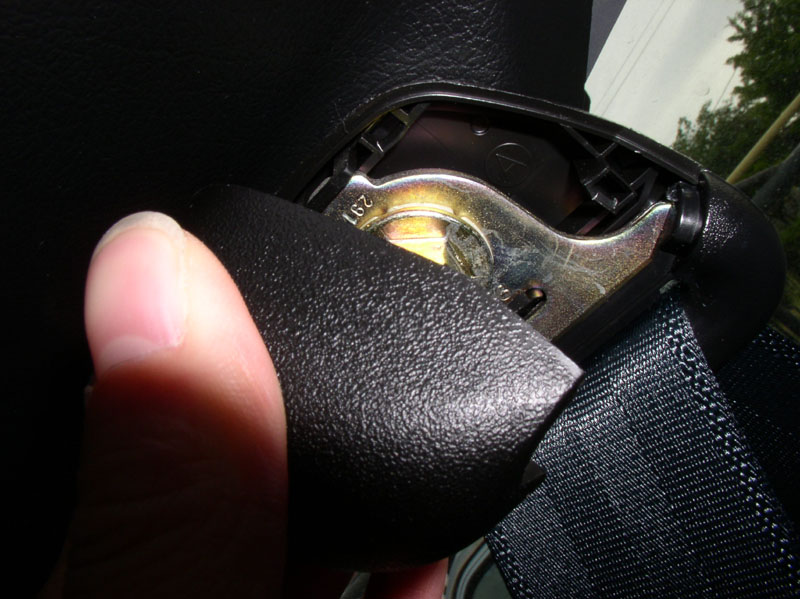

Thanks ALL!
Gee..never thought it was two pieces.....
