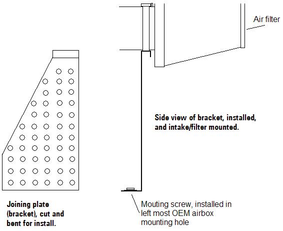

When I was "testing" a new intake system I made my own bracket to hold the filter up and stationary... here's basically what I did.
Went to Home Depot, bought a lumber joining plate... rectangular steel piece with numerous nail holes in it that sits between two pieces of lumber, end to end, and keeps then joined together when nailed to them. I bought this because of the numerous holes = numerous screw hole options.
Looked at the far left mounting hole for the stock airbox, bent the joining plate to form a lip to sit flush over the mounting hole, then sat the intake and filter over the new mounting bracket (joining plate). I measured how long it needed to be to reach and slightly bend through the air filter clamp, then cut a diagonal piece off to form more of a "bracket" type look.
Here is a VERY rough (thanks MS Paint!) illustration of what I am talking about:
That's what I'm talking about!!! Thank you, thank you, thank you... I will go with that right away...
Thank you!
No problem. I hope you understood (understand) my pic... it is a very easy piece to make, as long as you have something to cut it with (tin snips work fine), and maybe a drill to make the hole you are going to use a little larger.
Good luck and let us know how it goes.

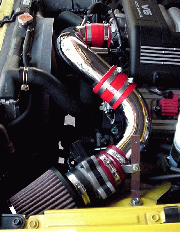

The bracket the Hot Shot intake shipped with is made from two pieces: an "L" bracket with a small piece of "s" bent metal (the top of the "S" is held in place under the hose clamp around the top fo the MAF. This bracket lasted about a year before snapping off at the top. Here's a pic:
I've subsequently taken apiece of heavy bracketing that I had laying around and attached it extended from the same bolt hole that I drilled on the Hot Shot bracket. It stickes out like a "t" now. I then took two zip ties and distributed the weight of the MAF over its length. It's really the weight of the MAF/Filter combination that pulls the intake down and makes it move. The modified bracket has worked fine for me so far (I painted it black so it won't be as noticable).
