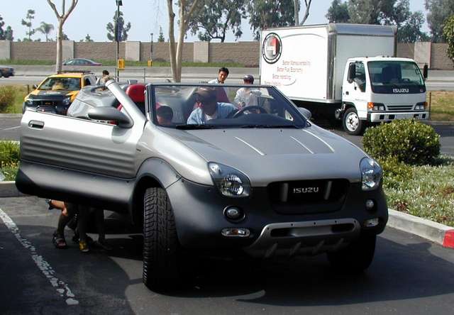

    I am not going to just chop it off! and what about the VX02? it is topless, isn't it? I would like to really and carefully plan this to make it look good. If I go through with it that is.
    Case in point. It looks awkward and "forced", as we say in the design profession. But hey, if you're absolutely certain that you'll love the way it looks and that you don't care about the concessions you'll have to make re: performance, then my opinion should really not matter. Taste is a completely subjective thing.

    i'll SAY, subjective!
    the VXo2 is bad *** hell. sorry, it is. that's just my subjective opinion as a designer though. i don't know many VXers who wouldn't love to get their hands on it. (especially anita!) with that said, this mod is not worth the money and time and loss of integrity (the car's integrity) that you will incur. put a nice sunroof in it and then trick it out with every other mod you would like, because that's how much you would spend to make the VX topless.

    I actually agree with this. The beltline is much too high for a convertible. Like sitting in a bucket.
    The VXO2 looks like a truck with the top chopped off, not a truck designed to be a roadster. The Chevy SSR has a similar problem. The beltline is just too high.
