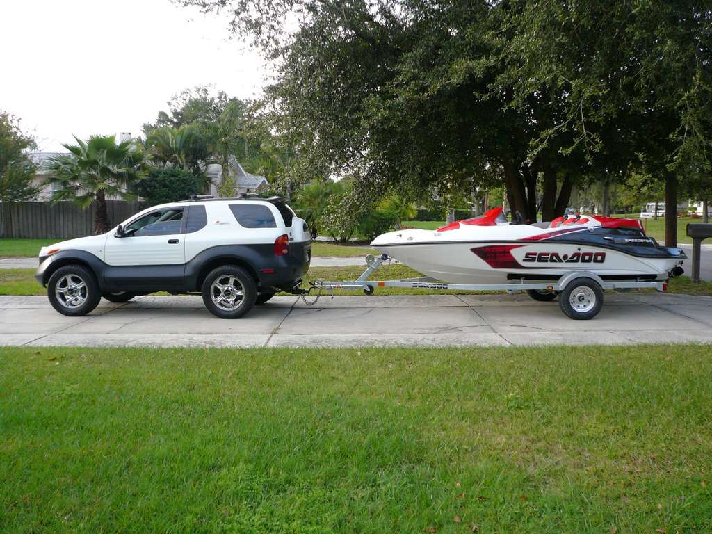

    Hitch working out well...
    Is it possible to attract even more attention than the VX? Try the VX towing one of these!
