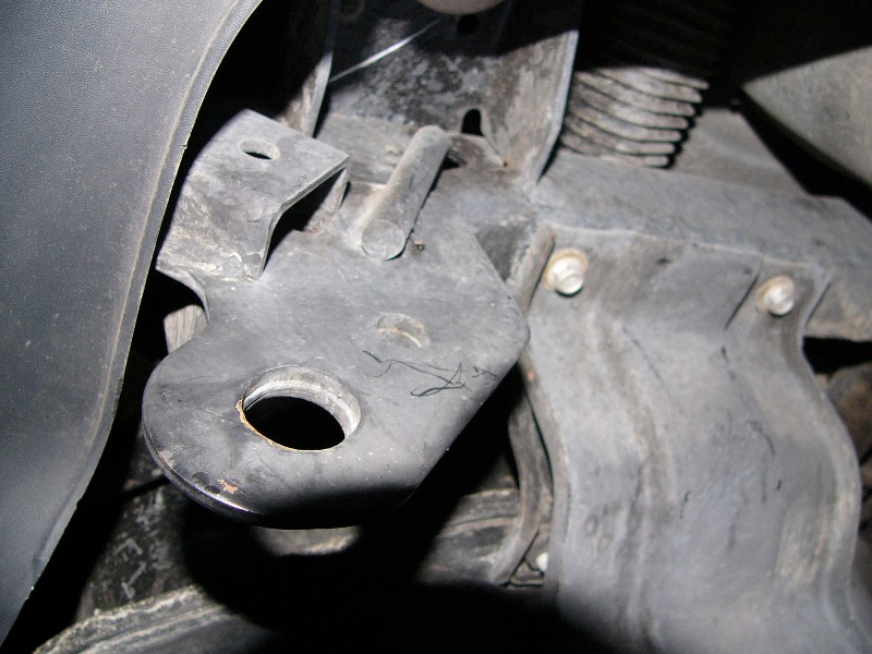

    I bought this hitch (Reese #37042) and couldn't make it work. What stopped me is, it seems my passenger side tow hook is welded on:
    I took the bolt out of the driver's side one and it fell off fine, but when I took the bolt out of the other, the hook wasn't going anywhere. For those with hitches, did anybody run across this problem?
    I think I could have got this hitch to work, if that hook would come off. Even the Dalan/Curt #12556 and the Reese #757235 that are supposed to fit the VehiCross require that those be removed. I just don't understand why or how mine could be welded on (original owner/no wrecks).

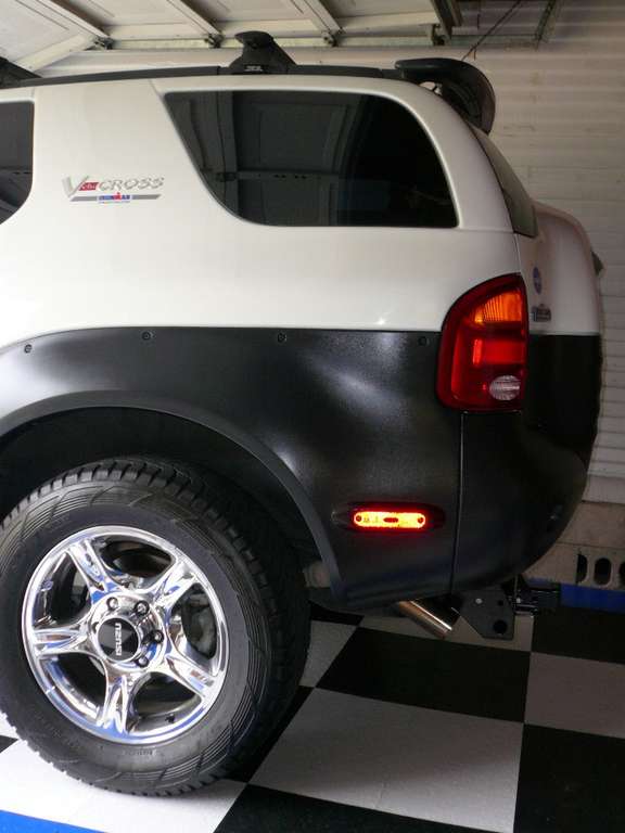

    Sorry, turned out the hook was not welded on, but had two extra bolts way up on the end of the frame. The only way to get to them was to take the rear cladding off.
    I got the hitch put on, but would NOT recommend it to a friend. I invested 16 hours last weekend to get it on properly. If I knew I would have to do half of what I did to get this on, I would have gone with Tone's from the start. This still involved cutting metal, drilling (of course), and cutting cladding.
    On the plus side (besides $110), the kit has brackets that bolt onto the truck, then the hitch bolts onto the brackets, so now that the brackets are firmly in place, it would be just a five minute process to take off the hitch or put it back on, if I'm worried about ground clearance. I agree with someone's comment that it looks aggressive and fills in a void down there, so I don't mind leaving it on, but Tone's would have looked nice too.
    (probably should have pulled out of the garage to get a better picture, but it was about to rain)

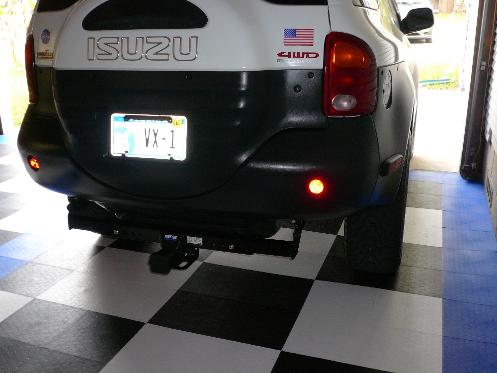

    This is a Hitch I had installed by Uhaul.. awesome skid help
    Attachment 761
    Attachment 762
    Attachment 763
    And ya.. itsa Dragon
