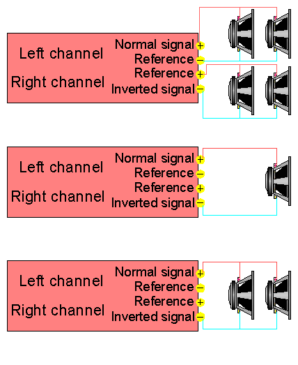

    You should be able to "bridge" the amp for one sub. That means use the outer (+) side of say the left speaker outputs and the outer (-) side of the right speaker outputs on the amp. This will essentially double the output power from the amp to your single 10" sub. It shouldn't hurt the sub at all even though the rating is higher than the amp output.

    The way I understand it, the amp is rated at a certain number of watts... you then divide it up by the number of channels (1, 2, 4), although, you will see almost all 2 or 4 channel amps out there state something like "400w amplifier, 4 channels, 75w per channel"... it doesn't add up, but that's how most do it. When you bridge, you use a positive (+) from one channel and a negative (-) from the other... 2 output terminals, both of which have signal on them.
    You do this to increase the power to the sub... meaning, on a 2 channel, 4 ohm, 250w amp, instead of pushing 75w - 100w divided by 2 channels, I am now pushing 200w - 250w by 1 mono 4 ohm channel. You can also bridge into a 2 ohm or 8 ohm signal, but only recommended for speakers that take that load.
