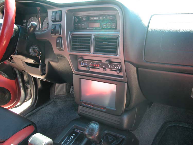

    For a while I had a PC running in my VX. It was an EPIA 800, in a custom box underneath the drivers seat, and a DC-DC PSU under the passenger seat. The display is a custom mounted 7" wide touchscreen LCD - running at 800x480. That's VGA, not NTSC. I molded the display case out of fiberglass and replaced the ashtray/lighter/cd changer with it.
    First, the EPIA being a MINI ATX, is only 170mm X 170mm.. Very small. Small enough I have that mainboard, a 30gig laptop HD, and radeon 9800 all squeezed into the same box - again under the drivers seat. There wasn't enough room for the PS, so that was secured underneath the passenger seat.
    My EPIA wasn't weak as hell. It did everything I wanted to do, and only required minimal cooling (the trade off).
    As far as it ridin' in the car, it was in there for almost a year and never once did I have an issue. Despite the VX's stiff suspension. Laptop HD's can withstand an enormous amount of shock, most usually rated for 300g's operating, and 950g's parked.
    For GPS I was using co-pilot 2003, and it was great with the routing and voice driven directions.
    It would have been trivial to install a USB camera for backing up, but i never did get around to doing it.
    I ended up paying around $900 total for my current setup (almost a year and a half ago). Pretty cheap, that's a PC that does quite a few things. You can go cheaper then that by say using a desktop HD if you'd like. Others have done it without problems. I personally didn't take a chance as I didn't want to have to remove the system when I went offroading.
    I also used sorbathane shock mounts on the system enclosure which shaved off about 70g's worth of shock.
    Also you could purchase a NTSC monitor instead of VGA - though I wouldn't recommend it. The type of monitor I bought was a Xenarc, then I tore it out of the OEM casing and put it in my custom molding. The xenarc can be found for about $100's cheaper then the price I paid for it at the time.
    I just recently ripped the system out preparing for an upgrade. New LCD with brighter backlight and dimmable inverter. Replacing the Epia 800 with a Epia M10000, adding a remote slotload CD/DVD, and new stereo with Aux in (I was using a FM transmitter for mp3 playing - it sucked).
    I had photos of it running but never could find'em. Here's some pics of the indash molding I did for the monitor.

    nice set up in the pics above as well (i was composing this when it was put up) and the extra info was very helpfull!! thanks!
