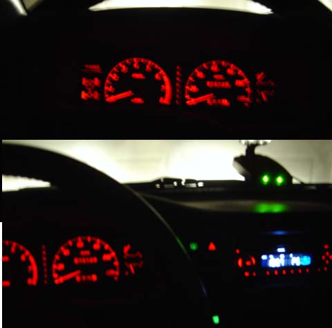

As you can guess man i took it out and switched it up4 Bulbs like you said man. The other stuff: TOD/PRD123 I "painted red" Takin pix tonight so check back.

There were 4 main wedge bulbs that i change to some apc red bulbs, the TOD and Turn Signals I Scraped the green off and painted a clear red over.....The gauges have a orange type tint on the back but it turned out great, you cant tell but in person it has a blood red type glo....VERY HAPPY ;Dr; For me very much worth tha risk.....x

The TOD and Turn Signals had a green film/paint on them that i easily scratched off with a knife and then with spraypaint "model car clear red taillight paint" sprayed it the red and THANK GOD, it came out good lol and Im VERY happy with it like i said tha pix are sooooo sucky compared to it in person.
The red probly came out so well cause as i mentioned before the gauges had orange tint behin them so if ya got a different color in mind take that orange into consideration....x

Finished my dash conversion:
Man, I need to drink less coffee before trying to take pics![]()
I used 4 red #194 lights and painted the one little corner one (#74) red. I also made the PRND32L red by coating the back with headlight repair tape. I was annoyed that I couldn't change the color of the TOD light-up bars because the backlights themselves are green. Any suggestions from those that have been in there?
My goal is to eliminate all green from the cabin. It annoys me.
