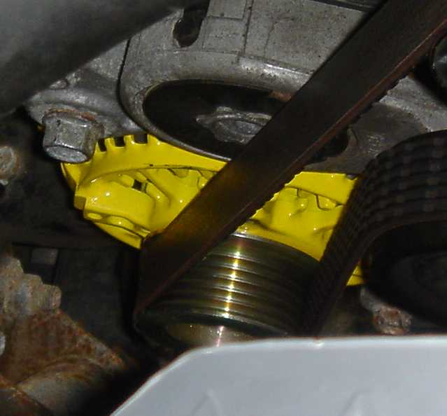

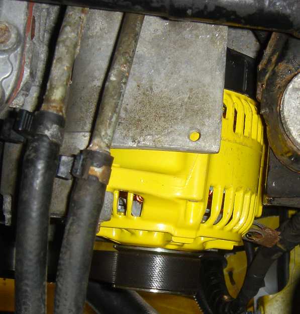

    Thats the one Rick did for me.
    Installation is bolt one, with the exception that I had to file the case a slight bit because of the thickness of the coating.
    the alt linked in the PlanetIsuzu link is NOT a direct bolt on or connector match for us.

    As for the alts that failed in Florida is was NOT the water - our alt gets wet all the time when it rains and is NOT the issue. Conductive mud and sediment is what takes out alternators like these - shorts them right out. Lisa took hers through a 10' wide mud hole just deep enough to get in the alt and it blew before we were half way through. On a previous trip to the slab, 5 of us went through a 50'+ long drive through the 3'+ deep river (Jennifer even deeper) at the Slab (several times) and all of came out fine in '99-01s.

    I'll 2nd the concept that it isn't fresh water that kills alternators, but the grit and grime that make water into mud. I've had more than a handful have bearing failures (2 or 3 delcos, 3 Isuzu alternators), and two electrical failures along the way. There are shops that can rebuild alternators with better (sealed) bearings if that's what you have fail out of warranty.
    I'd happily take a powder coated alternator housing. For some reason my alternators always seem to corrode more than anything else on the truck. I'm pretty sure that powdercoating won't effect cooling, but it is something to think about. Paint won't radiate as well as metal, but I'm thinking that the internals produce the heat and the fan cools them directly, not that the case is being used as a heat sync for the internals.
