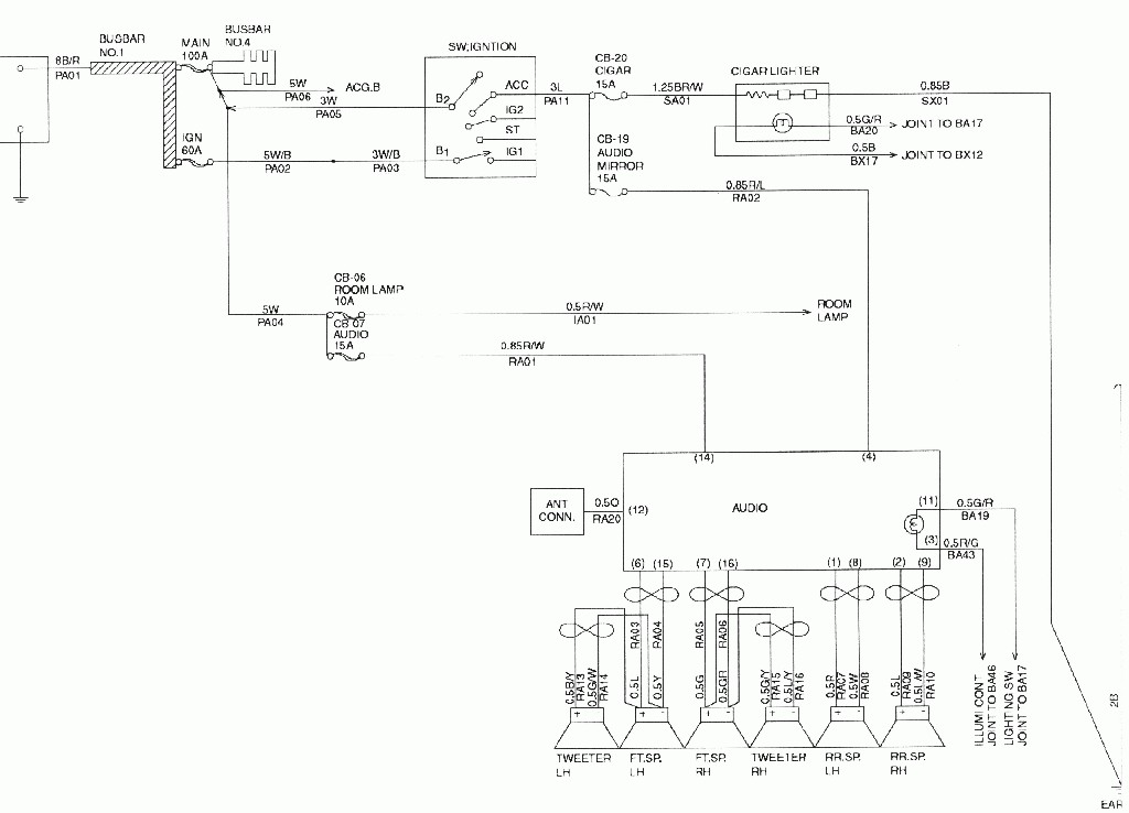

    I prefer this radio wiring diagram from the VX manual CD:
    The "L" is for the color blue. The other colors seem just perfect except that they all have gray spots on them, which is not reflected here.
    http://www.vehicross.info/gallery/da...dio_wiring.jpg
