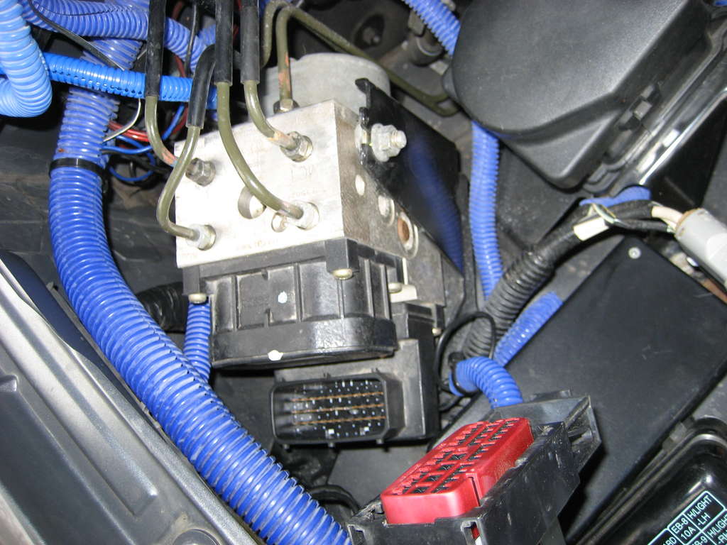

locate your abs module
find the wire harness connected to it, on the right side of the harness there is a little nub you can grab onto, pull it straight out (sideways from the harness) until it wont go any further (should pull out about 1-1.5 inches
remove the harness by pulling straight upwards
using the 10mm crescent wrench, undo all 5 connections on the abs module.. the threads are pretty deep so it will take you a little while, i started in the back, then did the two on the right then the two on the left, but i dont think order matters
after getting each one unscrewed completely i let it rest in the abs module still to keep debris from getting into the lines
take the 12mm crescent wrench and undo the two nuts holding the abs module on either side
be careful not to bend the brake lines, gently move them out of the way and wiggle your abs unit out
mine took a good amount of wiggling, but i also have about 3 trillion aftermarket wires running through that area

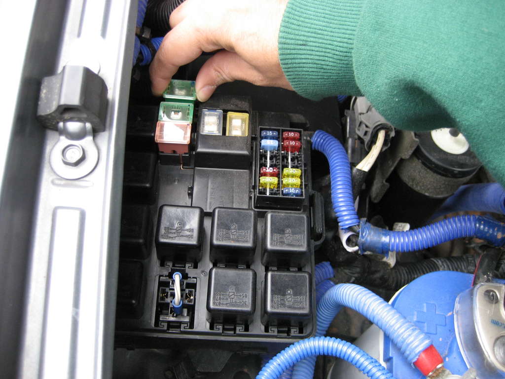

remove the abs fuse
find someone to sit in the drivers seat of your vx and step on the brake pedal
did you remember to remove the abs fuse?
start the vx... curse the fact that the abs light is back
if your abs light is not back on... remove the ABS fuse!
