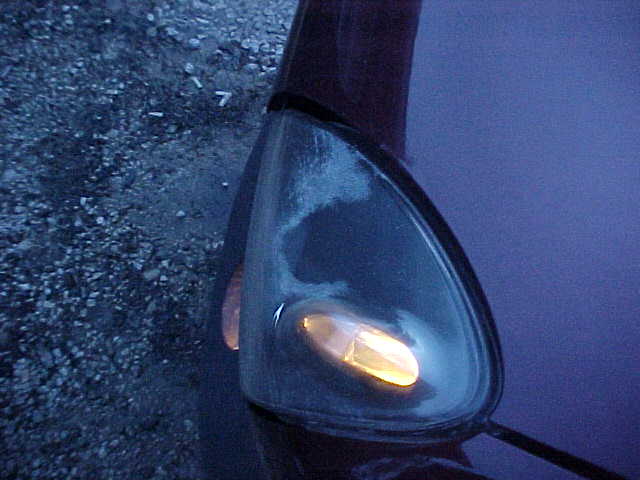

This is what my headlights looked like when i bought my 2001.
Pretty kruddy, and it really distracts from the beauty of the truck, I couldnt stand it, and although there are buffing compounds, and buffing wheels available from eastwoods. frankly, I didnt want to spend that kind of money without trying some other alternatives.

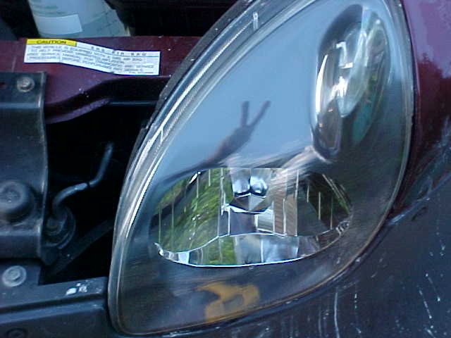

Spray down the lens, and 1500 sandpaper completley with water.... Lots of it, and begin sanding the lens in overlapping circles with LIGHT pressure. DO NOT RUSH THE PROCESS WITH PRESSURE. You will feel the paper "hang up" on the oxidation. Just keep using LOTS OF WATER. Spray water, sand in circles, spray, circles, etc. dont stay in one place, circle all over the lens several times with lots of water and you will start FEELING the lens becoming "slick" under the sand paper. it should start looking like this...
after getting the lens slick with the 1500 grit, spray it down and wipe it clean with some paper towels. Now dont be scared at what the lens is looking like. Check the areas where the oxidation is, or was. If it is still present, continue with the 1500 grit LIGHTLY in those trouble spots.
If oxidation is pretty much gone, and the lens is feeling slick, then move on to the 2000 grit, and repeat the process just like the last step. LOTS OF WATER, I CANT STRESS THIS ENOUGH. Again, circles, water, circles, water, and again, you will feel the lens getting slicker. These two processes will take about 10 minutes, maybe a little less. Just dont rush it. Your lenses should look something like this now.
