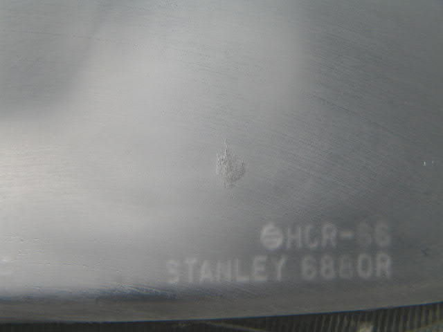

I then used a 6 inch Buffing String Wheel, item #13029 that I attached to my bench grinder and Buffing Compound – Plastic, item # 11924 that I bought from Eastwood Co. http://www.eastwoodco.com/index.jsp great supplier of ‘Unique Automotive Tools and Supplies’. (Just be careful not to burn the headlight.) Then hand polished with One Grand Plastic Polish, Product ID 10217 that I bought from http://www.carcareonline.com/ , a great place for car care products and how to tips.
![](http://www.vehicross.info/gallery/data/500/thumbs/IMG5.JPG)
If you look just above the L in Stanley, you will see the blemish that was left.
