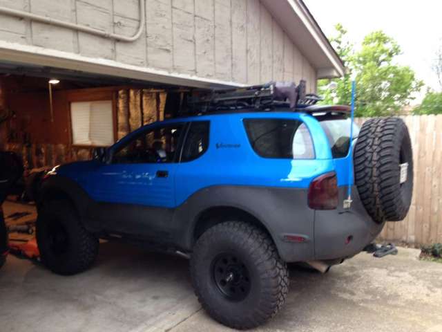

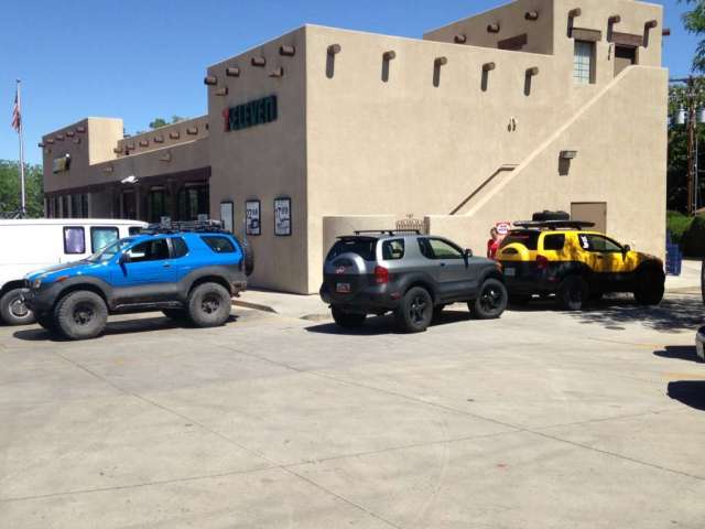

    I'm currently traveling so I can't take any additional pictures but here are a couple more.
    Hope this helps

    Quote Originally Posted by bartmanS4 View Post
    Hope this helps
    I couldn't see the first images just yet. Some images just won't load on a government computer. (Your tax dollars hard at work) However, these did, and I REALLY like it! I will try again once I get home and maybe I can see exactly what is actually there.

    Nice mod! Finally got to see all o the pics!
