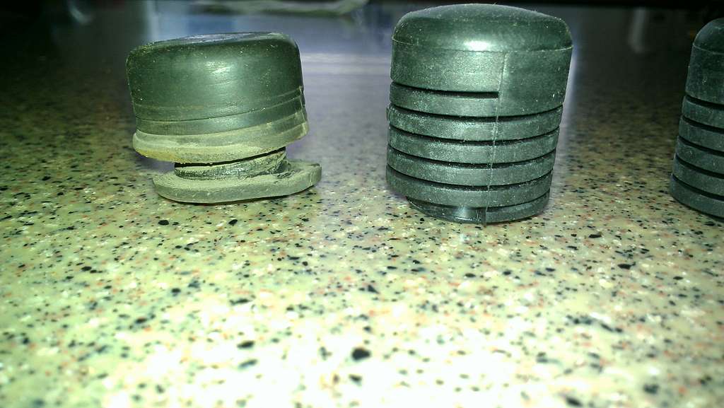

    There are a couple of rubber bump stops underneath the hood near the front. You can adjust the height by turning them. Extending the stops will keep the hood from rattling around too much and making squeaky noises. I believe counterclockwise will extend these stops. Just adjust both in quarter turns and drive around after each adjustment to see if the squeaks disappear. Hope this helps.
    www.aftershockproducts.com
    Agree with Rudy...if they're like mine then they are TOAST but you can still get them new from isuzuparts.com at a good price.

    The rubber bumps did the trick...I never thought silence would be so golden...no offense to Crickets!!
