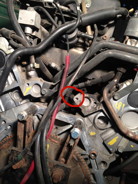

    Rodents have nested and eaten this wire in the middle of my V6 engine. I do not know what this wire is to, but it is disconnected to whatever connection IS down deep inside the engine area that I cannot get to. SEE PHOTOS PLEASE AND LET ME KNOW WHAT IT IS? Red end of wire is the part that became disconnected.
    I imagine it is to a sensor or indicator of some kind, nothing showing up on instrument panel EXCEPT the check engine light which goes on intermittently and I have yet to be where I can get the code read at that time.
    I have a constant woodrat / mice problem as I live up in the hills, surrounded by Oaks and a seasonal creek and have no garage, just a carport. I leave my hood up when parked and have the electronic sonic repellents plugged into a solar panel, but once in a while I forget to turn them on. It only takes one night... sigh. Use Pet urine neutralizer too.
    Appreciate ALL serious comments, thanks all!

    I truly appreciate all of your sacrafice! heh heh. VX runs fine and starts fine, just engine light goes on and off. The wire is a solid red ( the black in the photo is electrical tape from a former chewing incident that did not disconnect it ). The wire appears to be twisted copper and about the thickness of speaker wire.
    Maybe if we knew what the plug or wiring harness was that it is hooked int, that would help? It is circled RED in the 3rd photo.

    Ah, so the pic of the wire hanging down in front of the timing belt cover (2nd photo) is not the actual routing? That pic just shows the wire pulled out front and center so a pic could be taken of it?
    It appears then that the wire runs under the black plastic engine cover from the front of the engine towards the rear of the engine on the passenger side? If that's the case, then the black plastic engine cover can easily be removed just by pulling up on it since it's just held on by four rubber grommets. Once you have that cover off, maybe the other end of the wire would be visible?
    If on the other hand the wire run more towards the center of the engine underneath the intake manifold, it's possible it could be a wire for the knock sensor. If it's a knock sensor wire, you would probably experience a lack of normal power under heavy load due the ignition timing being retarded.

    Yes Y33TREKker, it was pulled out for the Photo. It does run towards the back, but much deeper than just under the manifold cover. Forgive me, I am not a gearhead and that's the one reason I am asking all you folks, hahaha. I guess you would call the area being in the middle of the engine, under the manifold between the 2 V shaped sides of the engine where the pistons are? A really nice little nesting place for critters. I have to vacuum out nuts, etc. occasionally when I catch them. Since I live in the hills, I don't always have an opportunity to be where I can get the code read... WHEN it comes on. I also have health issues, so I don't get around as much as I would like, but I am focusing on getting this checked this week.
    Mechanic had said that he would have to take all the manifold and everything above apart to get to that area to try to figure out where it was attached.... not sure I could do this myself?

    Thanks for the effort and reply Y33TREKker, When the critter chewed it before, it was still connected, that's why I saw it leading to the back of the engine.

    Hi,
    Finally made it out to my storage for your pictures.
    The plug attaches to either a Temperature or Pressure sensor about center of the block under manifold. These pictures were all shot from the rear of the engine with it on an engine stand.
    Don't think you'll be able to get to it from the rear, access will be very tight if you can even get to it.
