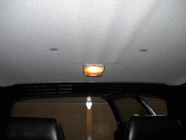

    Anither great tie in would be a 2nd dome light towards the back
    Dan/2001 Proton/MD

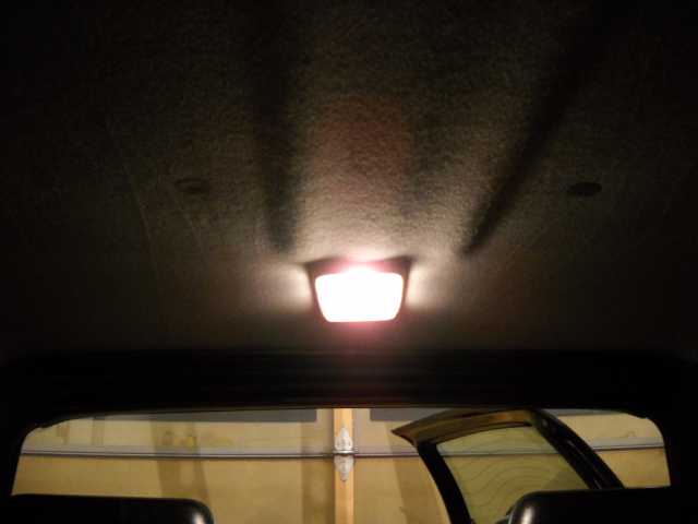

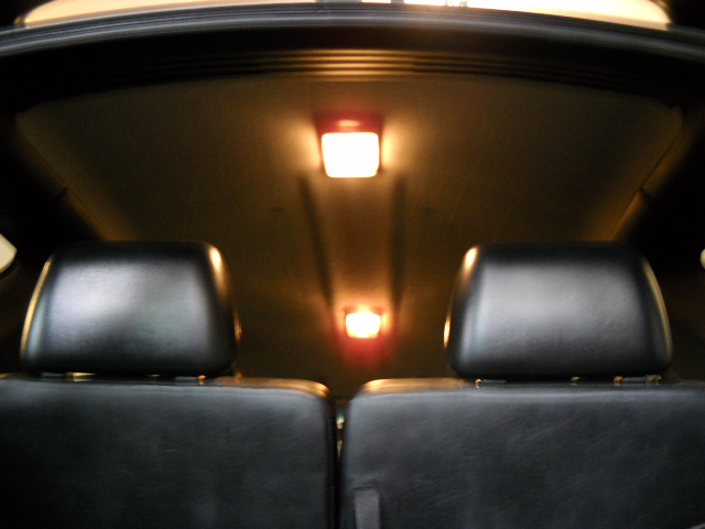

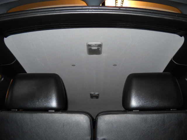

    Like this....
    I tied mine into the front light...if I get into the back I just push the cover and it comes on. I used a OEM VX front lamp for the rear. Pretty easy to tie them together using a metal coat hanger to run the wires.
    If I did it again I'd mount the rear one a little further back than I mounted this one.
    Oct 2005
    2001 Proton Vehicross
    676
    Yea thats awesome. I have a few spares i may do this. The back always so dark
    If you don't mount it far enough back the back seat will block the light and it won't help much...
