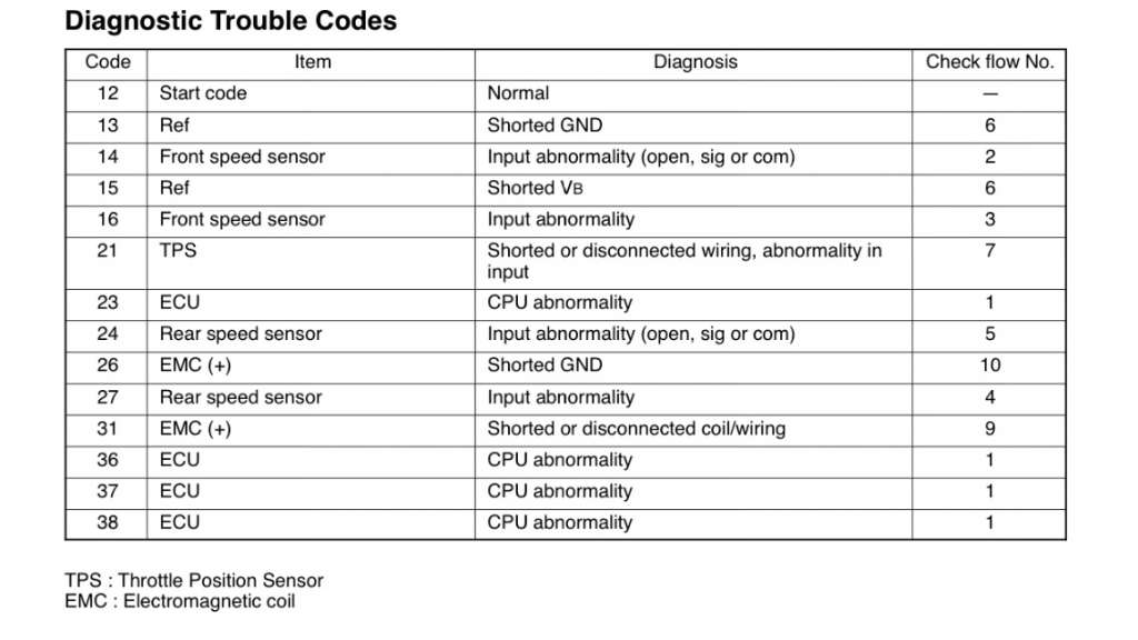

    I just use a paper clip to jump pin 4 and 8 I believe. Code 12 will flash 3 times followed by any error codes.
    Chris|2001|Ebony
    Aug 2014
    2001, Ebony, VehiCROSS, 0673
    28
    From my experience, most shops seem to have trouble reading any of the codes that the TOD ECU throws out. Any scanner that would be able to read them would run you quite a bit.
    My shop was able to read the codes once I provided the table and directions posted above. Turns out a lot of vehicles use/used this method for indicating non-ECU errors.

    I am having the exact same problem. It's flashing. Driving is very weird (unless I go in a straight line and do not turn the wheels)... My Scanner won't read the codes. So basically if I took my VX to Pep Boys, what do I tell them? Just show them this thread? Is that enough?
    I haven't drove my VX in 2 months now
    Ty
    Mar 2010
    2001, foxfire, 2001, 1117
    32
    Print out the thread and highlight the codes. Get the mechanic to come in and read them so he understands what problem you are having and how to get the info that is needed from the pin jumping. If they have issues I'd suggest they look up my pep boys (warwick blvd store, newport news va) and talk to them.

    After reading this thread and checking my TOD error code, I received a "shorted ground" error code (#13). Looked under the truck at the TOD and started from there...
    Long story short...It appears that the guy who replaced my catalytic converters and exhaust did a GREAT JOB on all that...however he didn't route the TOD wiring harness correctly once everything was finished. The wiring harness was laid up against the exhaust which melted through the wire sheath and shorted a few wires together. Once the wires were separated, repaired and secured properly, the TOD CHECK light went off and everything is back to normal.
