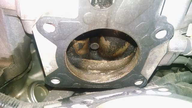

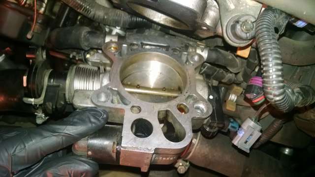

This video for a Rodeo, it's basically the same procedure for a VX except that the throttle on the Rodeo is electric, and ours is mechanical, so you'll have to disconnect the bike-shifter-style mechanical throttle lines (it should be obvious looking at them, but if you need help I can take pictures). I kept cleaning the manifold EGR tube from the valve side (using carb cleaner and a trombone brush), but I could only get it in a few inches before it couldn't make the bend, this video was what I needed to get at the rest of the tube. By taking off the throttle in the front and getting at the EGR tube from the other direction, I managed to get the whole tube cleaned. Also, I managed to get at the EGR tube without disconnecting the coolant from the throttle (the tricky bit in the video where he used a couple of bolts to plug the holes). Instead, I just let the throttle assembly hang there... unbolting it and moving it out of the way gave me enough room to see the hole and what I was doing. I'm praying my P0401 code has been put at bay for a while now, I'm pretty hopeful given the gunk I saw come out of there.
