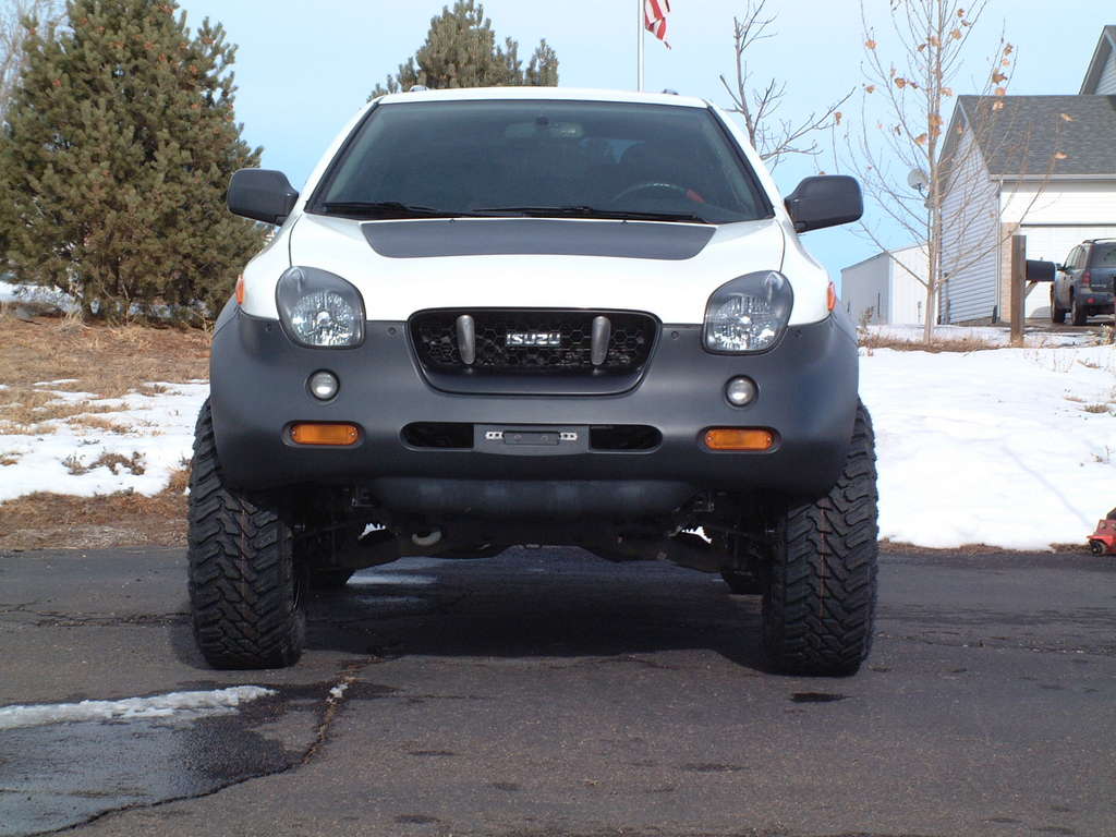

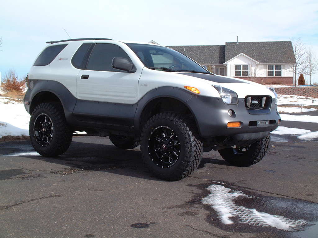

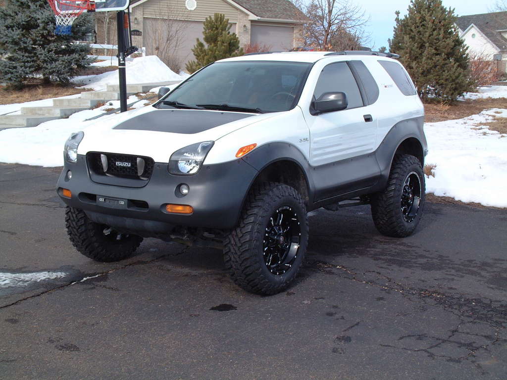

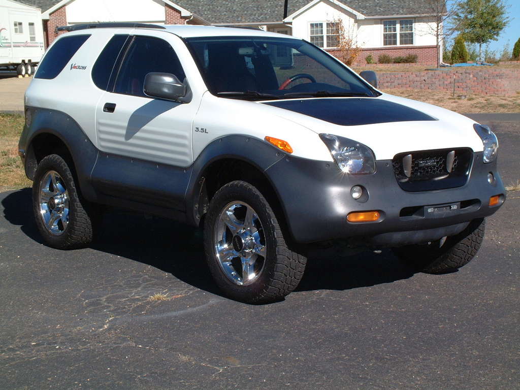

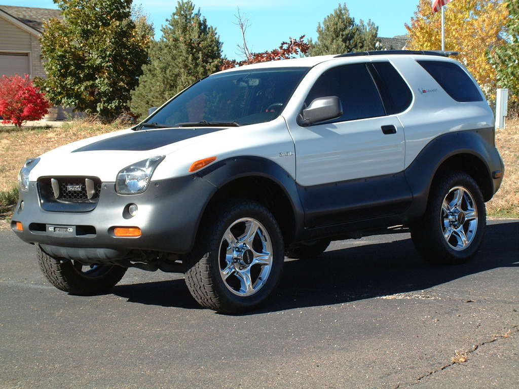

    Here are a few before and after pics of my '01 Ironman. I installed a (Indy4x) 2" body lift -"sucked", and a Pro Comp 1" coil spring spacer. Also got new 18x9 Ballistic Scythe wheels and 275/65R18 Atturo Trail Blade MT tires. Had to modify the front wheel wells as well. All said and done, it's sitting 4" higher.

    Lookin' good! Check that camber though. Looks a bit too positive.

    Looks GREAT.......
    Remember to do alignment if/after t/bar crank too
