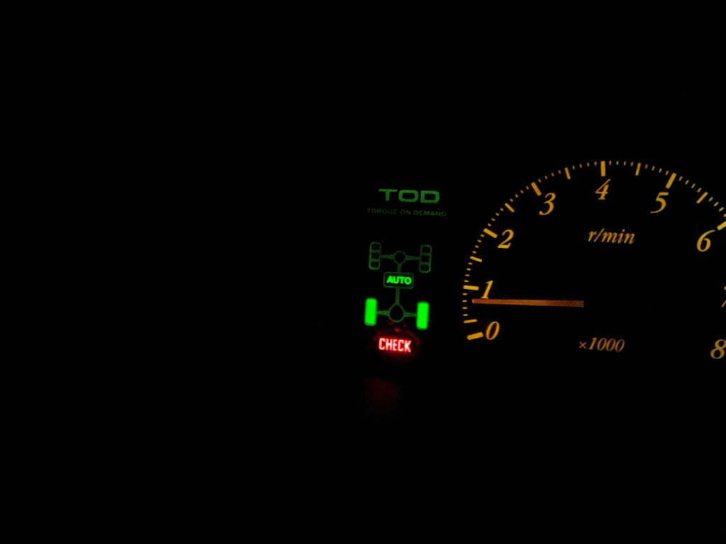

    The word "CHECK" in red letters is below the TOD indicator lights. Mine starts flashing about 15 min after driving & the TOD quits working. It hasn't been enough of a problem for me yet to try to chase that gremlin down.

    OK ... but here's where it is located for future reference:
    Not a bad pic for cell phone @ 6AM sitting in traffic on I95 ... if I do say so meself!!!
    BTW: my work badge covers that annoying light quite nicely so that it doesn't send me into epileptic siezures whilst driving.
