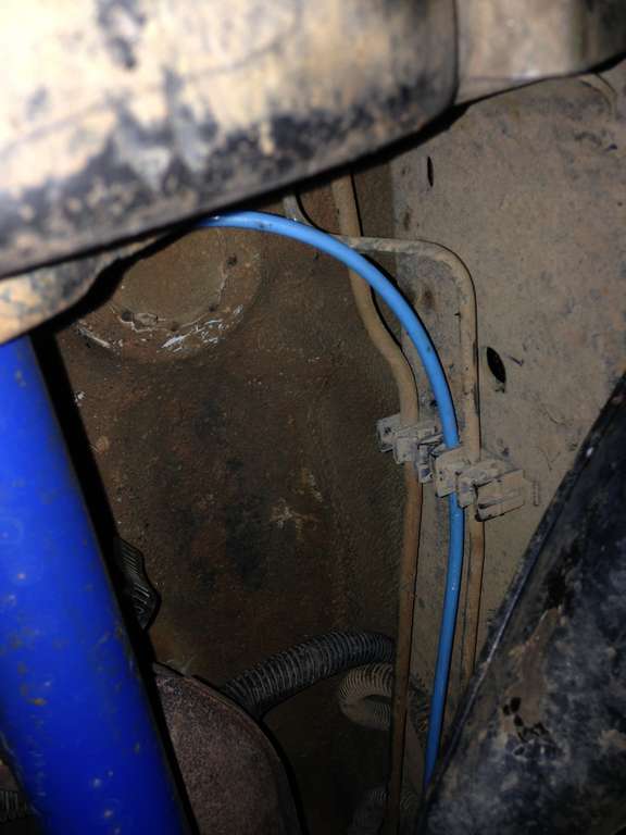

I then had to come up with an air source. A compressor is the usual route but I had a different plan. I had a CO2 tank and regulator from a kegerator that I wasn't using so I decided to go entirely pneumatic. I bought a pneumatic switch, extra ARB tubing, 5mm push in fittings, and a fire extinguisher holder. I ran the tubing along side the rear brake line using the spare clips along the frame. I routed the line just behind the transfer case and over to right under the e-brake. I drilled two holes through the floor under the console one for the feed to the locker and the other for the pneumatic switch exhaust and used pass through push to connect fittings to finish it out.
ARB air line

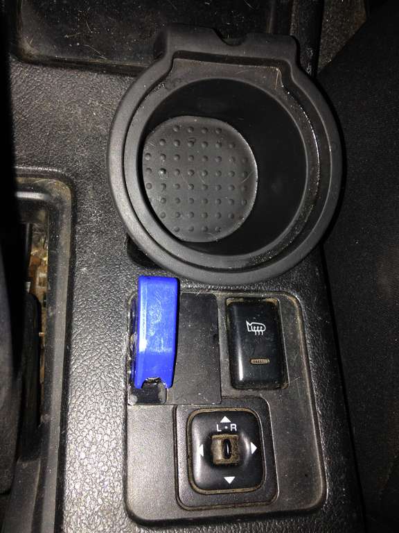

The pneumatic switch I used didn't easily fit in the switch blank next to the side mirror adjust so I cut out some of the plastic and made a small patch with a piece of aluminum. I sealed this piece in and mounted the switch to it along with a safety cover (blue of course). Next I drilled a hole through the back of the ashtray holder and mounted a pneumatic quick connect to the outside and a push to connect on the inside of the console. Then it was a matter of simply running the tubing inside the console to the appropriate fittings.
Clippard pneumatic switch
Safety switch down
Safety switch up

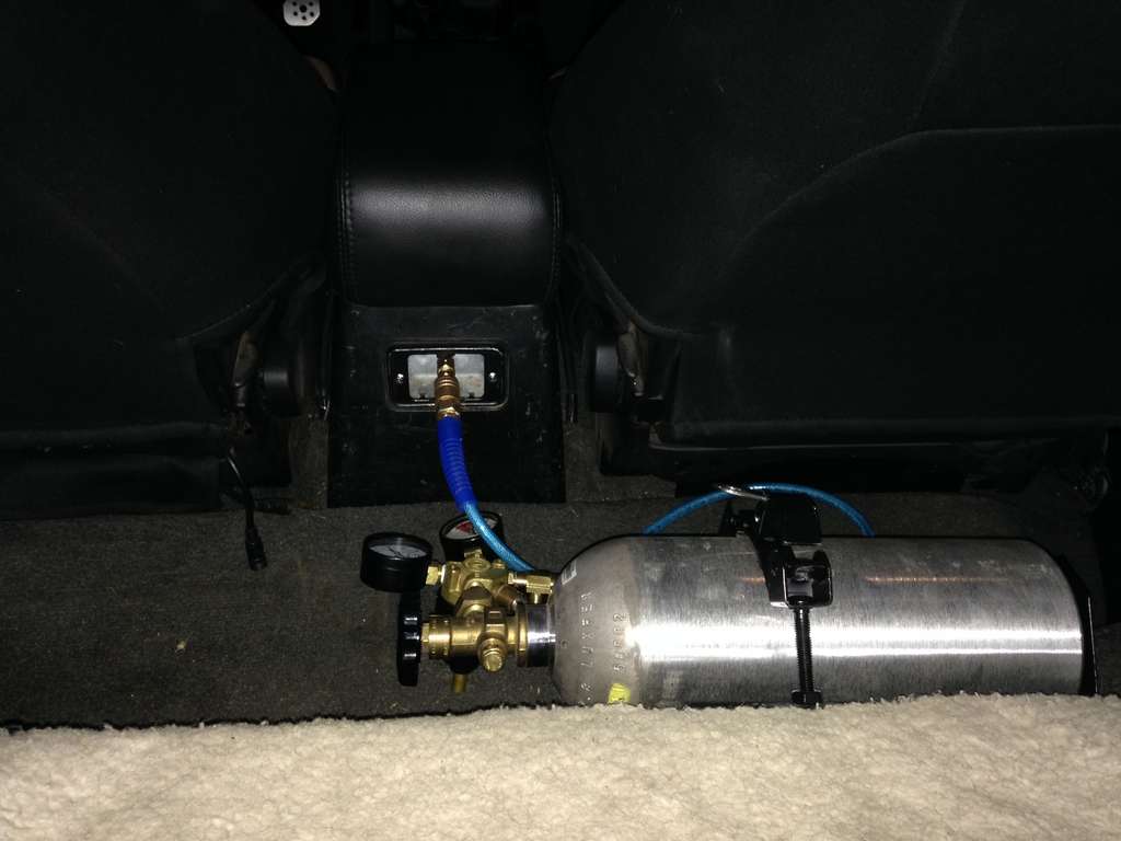

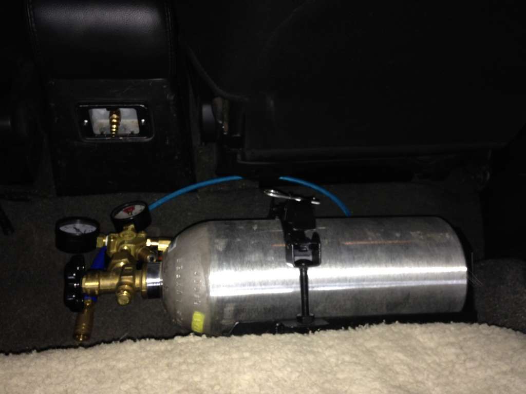

For the tank I wanted it mounted where I could reach the valve from the driver's seat so I opted for just behind the passenger seat. I used the available bolt hole from my removed rear seat to secure the tank in place.
Connected
Disconnected
